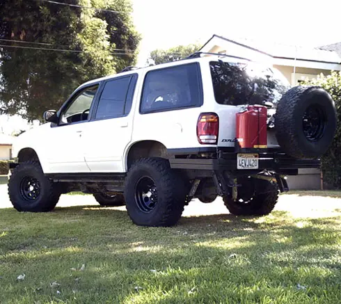

Made some new addition to the bumper this weekend.
Added a gas can mount, and a new CB antanna mount.
some of you wanted to know how it opened.
We also got the hinges to work right now. But some greese ant lock-tight, and seem to work excelent now. We will be changing the tire mount in the next few week too, sence I'm not happy with it. :rolleyes: We'll will just put a 2x2 out from what there with a flat plate.
Also got the Hi-lift out from inside. Ended up mounting on front bumper (see Stic-o's New front Bumper )

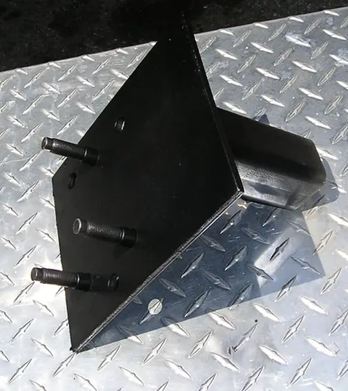

This is the new piece for the spare tire that we built. I don't like or trust the one on there right now. This new one is already pre-drilled to fit 5 on 4.5 or 5 on 5.5. Just move the studs ;)
we'll weld it on, this weekend. ;)

Welded the new piece on today tire sits much better! :thumbsup:
