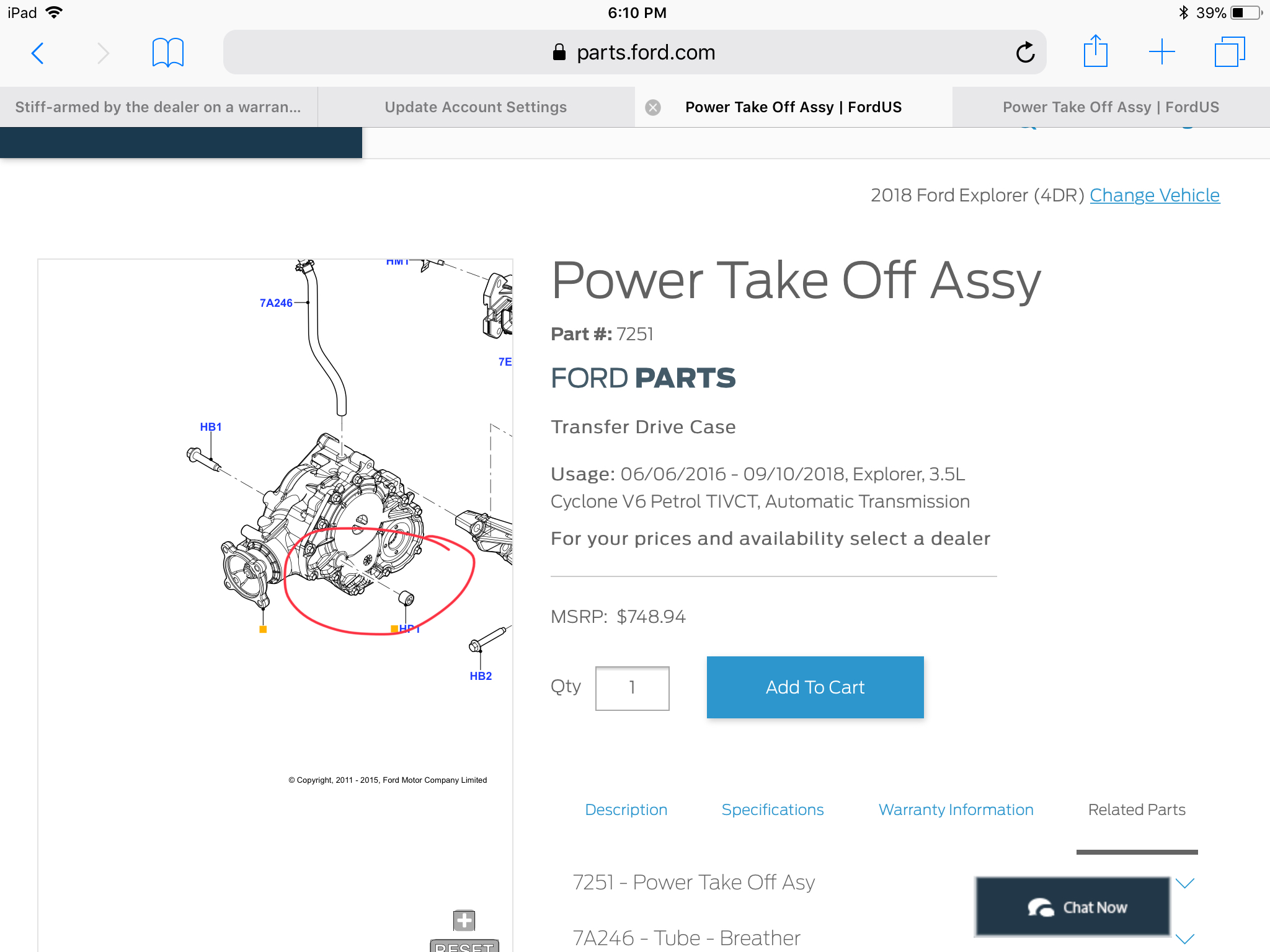

The more I look at diagrams of the PTU for our 3.5 Explorer, I’m convinced there is a plug on the passenger bottom of the PTU. I’m attaching the screenshot from the Ford Parts website showing the location and part description. For the life of me, I cannot get into position to see this spot with the car on the ground. If somebody with 3.5 no-cooler happens to snap a picture of their 2017-2018 Explorer’s PTU before I get a chance, flag me on it.

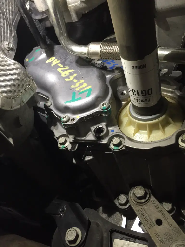

This A Regular Drain For Flush This Is In The Middle
Other PTU Have Drain Plug More Down

no, it's from an explorer sport, I just wanted to show you the difference
the 2012 has the plug in the middle you need a pump to drain the oil
