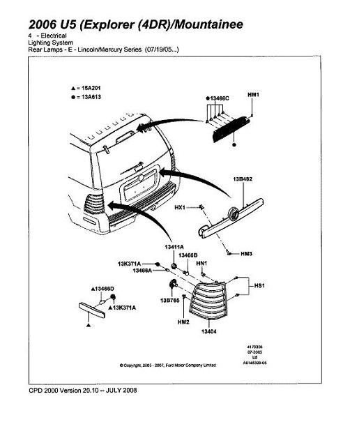

Just the way the Led is setup on the 06 & up monty's, The Led is circular (looks like a minnie chrome engine cap) & setup to project against the housing prizims to reflect the light outwards, pretty cool setup.

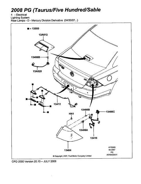

I hit up the parts depo. Apparantly, both the '06 Mountaineers and '08 Sables use LEDs for the brakes. The Sable's are $100 a pop and the Mounty's are $60. I don't see any reason why they would be different.

Shag, I'm curious because you say that you had to drill out the holes on the '06 clear lenses to fit your '03 bulb sockets. I'm assuming your '03 sockets housed normal 3157 bulbs. You would think the '06 holes would be much bigger than your '03 sockets because they were made to house those large cluster LEDs.
At first I thought it was insane the factory price of the LEDs, but $120 for a pair of them might not be too far out. Considering aftermarket LEDs are >$25 a pop and it is unanimous that they are never brighter than any kind of stock bulbs. I just want to know what kind of modifications (drilling out a bigger hole) I have to make, because I still have the APC all clear lenses and I know these are almost impossible to find anymore.
well after a week or so of trial & error i got these to fit right in and i was able to use the original wiring & sockets. so did i waste my time or what?
what say you?
