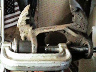

I have used a ball - joint "C" press to force out stuck bolts with great success..

The "C" clamp I used is pictured below... It can literally apply tons of force. It has a 7/8" head so I can use it with my impact gun which make it very fast and easy.. I you use a breaker bar the torq arm is LONG and will try and rotate the clamp (you have to hold the clamp in a vice to prevent if from moving). With the impact gun the torq arm is small so there is no need to hold the clamp)

okay i think im going to try to drill the bolts out today because the "C" clamp wont work. can u buy new metal sleaves from an auto parts store just incase i mess these up im going to start around 2:45 because thats when i get out of school i left the C clamps on over night and tightend them up every hour the c clamp was bent this moring so that idea wont work.
You are using the wrong C clamp, you need a ball joint/u joint press like the one pictured above, you can rent it for free at most auto parts stores.
