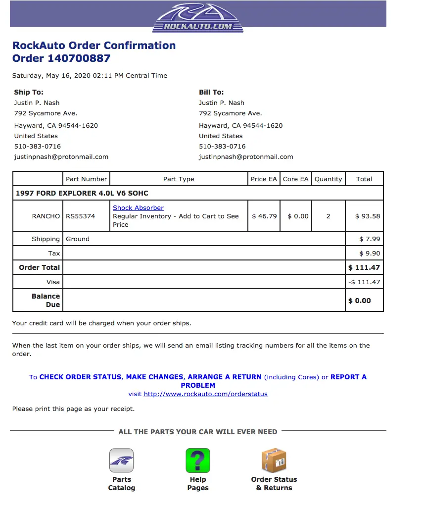

Rancho RS5374 replaced by RS55374.
"Use to depletion, then use RS55374"
