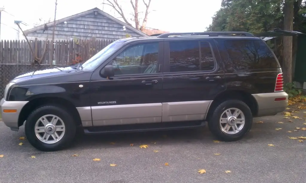

I did all 4 corners with Strutteks 1 month ago. RF +3/4", LF+7/8", RR +1", LR +1 1/8". Made for a mild lift all around but barely any differance from stock rake. The reason I had more increase in lift on drivers side was probably due to more wear on stock struts.
I've noticed that on Explorers with a class III hitch installed the rear end sits higher… But, ones without the class III hitch sit level… I always just figured it was higher in the rear to compensate for tongue weight when towing a trailer and to level out the ex while pulling. I see a lot of pickups the same way...
