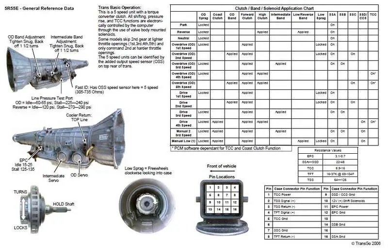

Thanks for this information. Could you connect a 0 - 300 PSI test gauge to the main pressure port, and the EPC pressure port to take readings in each gear range (with & without the electrical harness connected)?
Thank you BrooklynBay for all of your help. I will have to get a pressure guage and then I will let you know the results, it will be a couple of days cuz we just got a foot and a half of snow in the north burbs of Chicago.
This chart should help with the comparison of pressure readings & test locations:
thank you thank you , that will save me a few hours of searching!
