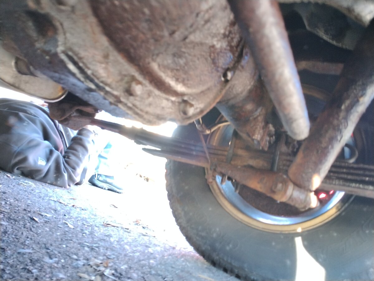

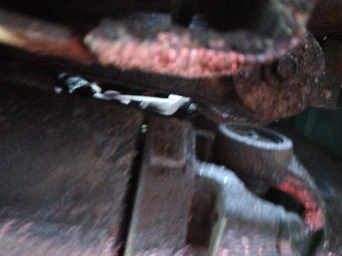

Please try to get pictures of both u joint areas, and highest area of wet on differential
seeson't know if anything is useful to see here as there is Fluid Film on it. The reddish color is not really there
