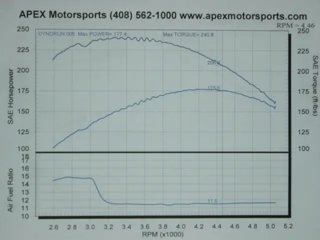

Dyno day has come and gone.
Went to Apex Motor sports today and made a couple of pulls for tuning. The Nombers that we got weren't quite what I expected. I'm happy none the less. It looks like we need to pul some timing and doctor the A/F ratio a bit. I also want to see about putting a smaller pulley to bring the boost down into a more effective range. More on that later.
Yeah, I would have imagined more than 177 hp at the wheel. Probably needs some more tuning. Either that, or there is something missing on the chip.
I was talking to John V. last week about your setup, getting some ideas from him. Keep us updated!
The Guru's are working right now on it. Doug was telling me that I have a lot of room here. He said that most of the time he sees 195rwhp without tuning. So hopefully the Apten magic man can work his miracles.
Yup, 195rwhp without and anywhere from 204-215 with in stock form, no camshafts or huge injectors. You got a good baseline with a very safe a/f curve. Start from here and work you way up.
later Doug904.
