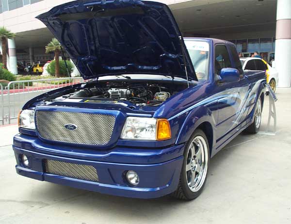

Won't be long now. Here is a Ranger from the SEMA Show that has our kit installed.
Don't mean to tease you, but here is a closeup of the engine.
SWWWWWWWWWWEEEEEEEEEEEET...
