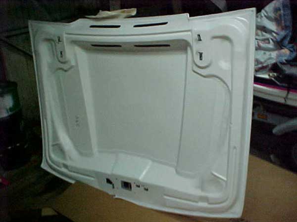

Since we know it is not going to fit under the hood, you may consider using one of our cowl hoods for the project.

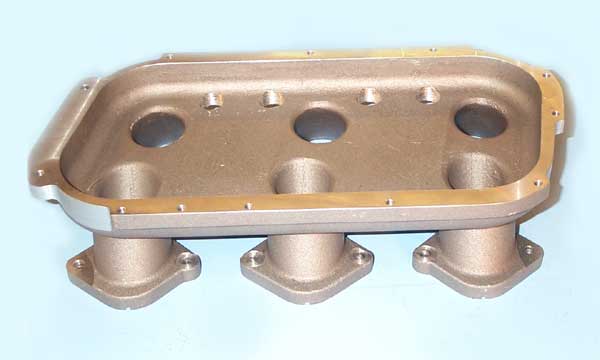

Before we get to excited about easily mounting a Supercoupe Supercharger assembly, there are many questions that need to be answered. How are you going to make it fit under the hood? Because an M90 wont fit. Each vehicle will need either a body lift or a new hood. How about the lower intake/discharge manifold. The 3.8 is totally different from the 4.0 SOHC. This part is not going to be easily fabricated.
I like the spirit of the project. But, you have to be realistic. If it was easy to do or possible to do, you would see a lot of these on the road already.
The is a picture of our discharge manifold. You will need something like this that will mount to the 4.0 on the bottom and the Supercoupe blower on the top.

You want to be able tograb a 3.8L SC for cheapo at the junk yard, take it home and bolt it to your SOHC?
For cheap? and fit under the hood?
Its not going to work. Its already been proven.
YOU have to fabricate parts, especially the adapter from SC to intake.
This is why EE has come out with a bolt on kit, just as BBK emgineered a bolt on kit for the OHV.
Can it be done?
Yes
Is it going to be much cheaper than the EE kit?
possibly, depending on your skills
Is it going to yield the same results?
not even close, assuming you are cutting corners to save cost
Is it going to fit under the hood?
Nope, not on a stock truck.
Got it?
You can try to turbocharge it too if you want.
But dont think any of these projects are going to be cheap or simple, especially if you want it to run good and make power.......
