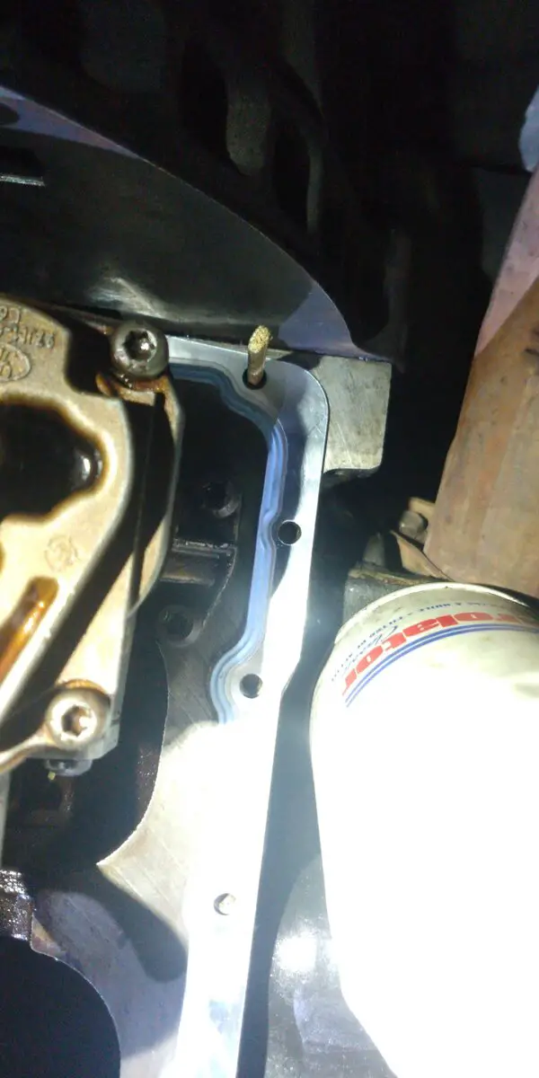

I installed the oil pan in the 98 ohv by using end pieces of sushi sticks to hold the gasket in place.
Couldn't be easier. Had to post this immersed in proud resourcefulness.

Very nice. Sound like something me and my old man would do haha it will be used when I replace mine!
