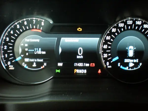

This is what mine looks like. It's the only picture I have handy. What I'm referring to is the digital speedo in the center display. Is that still available when someone does a 'swap'?
Peter
Yes you can still get the digital speedometer as a secondary indication. The "Four Corner" plus speedometer is the center display. Vehicle systems page are divided up among the two other LCD screens, fuel, settings, tire pressure, etc..left side and safety stuff, (ACC, Speed limit indication, etc...right side.

Update! Got my Platinum Speedo in! Its a big improvement over the old standard cyclops. Love that i have a real tach.
Are you able to display the digital speedometer in the center where you have the compass?
Peter
Yup! Person I bought it from, programmed it for that.
Your cluster has the latest software version, I can tell by the thin blue gauges (2018 Model Year) - I am running the same version on my cluster.

Yes, the 2017 software moved the digital speedometer to the center display and 2018 software updated the graphics slightly with modified gauges and thinner gauge needles. The physical hardware is the same.
