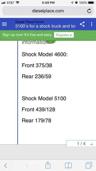

I then started researching shock valving. For my front shocks I ran Bilstein 5100 rear shocks meant for a 05 F350. In my research I found the valving on them is roughly 180/70. Stock valving on the Chevy duramax is in the pic
Telling me that our TTB (ifs) need a very stiff valve shock.
You may need spring rate (bottom out to easy) our you might need to revalve. If you hit a bump at 50 plus and it makes the truck scrimish I would stiffen the valving.
