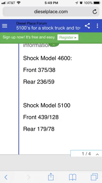

I then started researching shock valving. For my front shocks I ran Bilstein 5100 rear shocks meant for a 05 F350. In my research I found the valving on them is roughly 180/70. Stock valving on the Chevy duramax is in the pic
Telling me that our TTB (ifs) need a very stiff valve shock.
You may need spring rate (bottom out to easy) our you might need to revalve. If you hit a bump at 50 plus and it makes the truck scrimish I would stiffen the valving.
Also what is in the rear?
I have just finished my dual shocks in the front, both 180/70 ish so 360/140 together. If it compresses in the front the opposite corner will rebound. I plan on using 2003 f350 6” lift front Bilstein 5100 shocks for my rear. They are roughly 225/80 and roughly 16” compressed and 26” extended

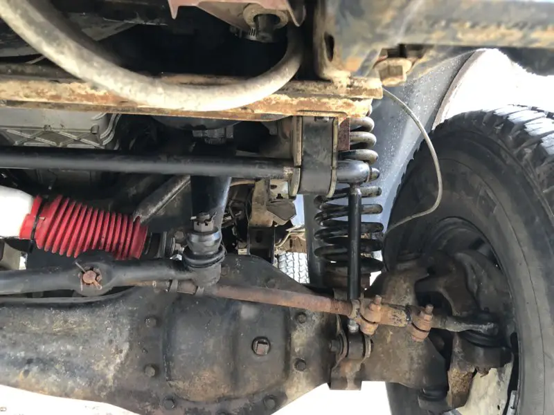

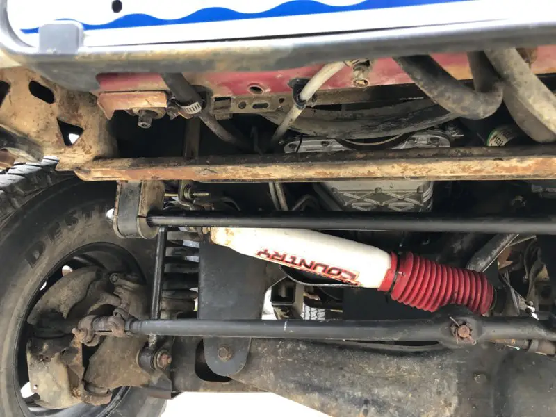

On my latest explorer that I just got recently, is lifted and on 33's. The PO took the sway bar off because he utilized the lower sway bar mount for a shock mount. I drove it around a few times up to highway speeds and I wasn't a fan of there not being a sway bar present. It reminded me of my days driving a semi fight a heavy side wind or driving around in construction sites bouncing around.
I reinstalled the sway bar with extended links and a steering stabilizer and it has cleaned up a great deal. I think this is honestly a case by case basis and how a person uses their vehicle to determine the need for a sway bar or not.

Please Photo!

That looks like a steering stabilizer?
