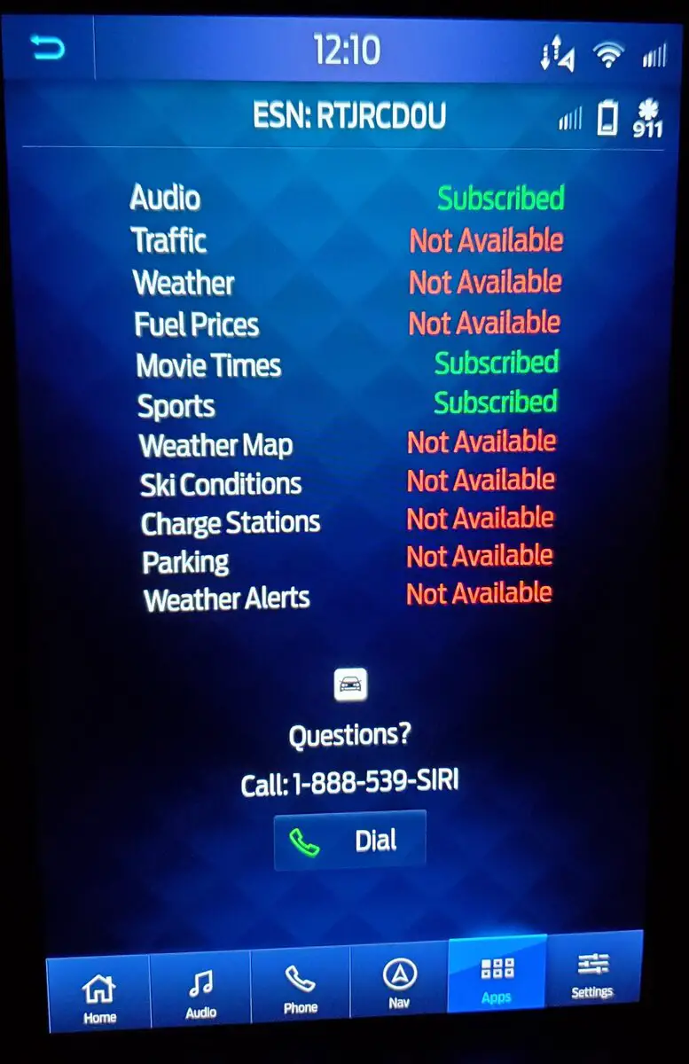

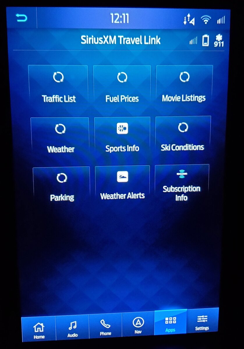

I did the update via USB on Saturday and it did take less than 30 minutes to complete. Today I discovered SiriusXM Travel Link is no longer working! I called Sirius and they said they would boost my signal whatever that means. It did not fix the problem. Anyone else having this problem? Prior to today, the information would load after a couple minutes of driving. Now after more than 20 minutes, they don't load.
Have exactly the same problem
after factory reset it working normal 2 - 3 times and go back to movie and sport only

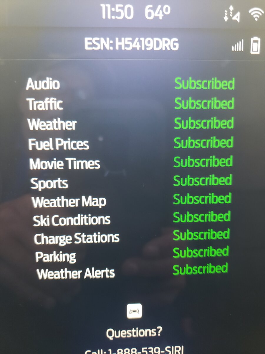

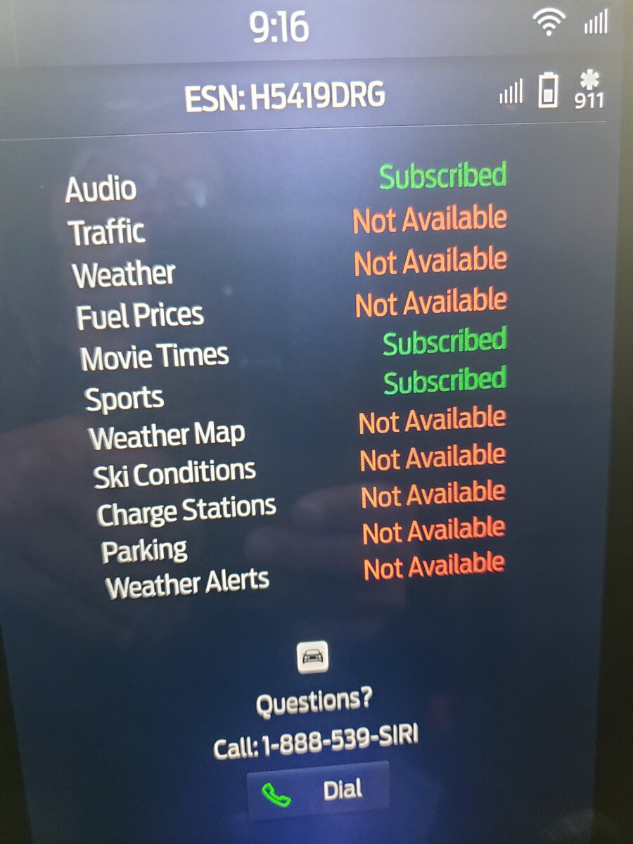

I solved the Travel Link issue. Found a SSM for some 2019 Fords that said to perform a master SYNC reset. GO to Setting/General/MasterReset.
After doing that it restored all of the Travel Link. You will need to pair any phones and change any settings that you had changed from factory after doing this. Attached are before and after the reset.

I'm happy to report that after 3 days the Sirius Travel Link is working again! No reset was necessary. It corrected on its own. I did check for updates over WiFi and it did download some. Maybe that's what did it.
