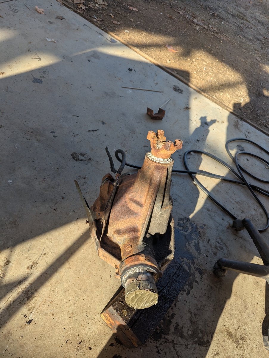

Here's today's update. Honestly, I was having analysis paralysis about welding the tubes. It seems that there's a thousand ways, and everyone else thinks they are wrong.
Well, I realized that I have a practice axle-Lloyd's broken Sterling. I decided to use Stain weld 308-16. Clean really well. Pre heat. 1" welds. Get frisky peening it.On my welder, I used 114A. I'm not Bacon Creek Metal, but I did manage to glue it together. No cracks
Im not one to think another way is wrong, if it works. I'm usually good at figuring out the ways not to do it by trial and error.

Is that a practice diff?
That's Lloyd's broken Sterling. I had to cut the tubes to get the broken shafts out. I wanted it for the gears. I'm glad I kept it.
I just kept fiddling with technique and amperage until it welded like I like. Even still, the Sterling welded a little different than the 8.8
