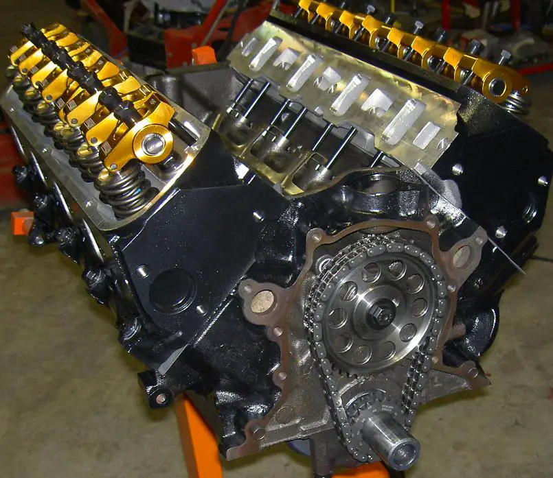

I've seen some enticing pictures of the Aussie SBF's. I like their accessory setup too. It's similar to ours, but theirs are made for cars, a bit shorter down on the engine. I thought about trying to find their two brackets, but it would also require the same PS pump and compressor, maybe alternator(3G versus our 4G). I'm going to see if our front dress will fit in my Lincoln first, under the hood.
Here's the Aussie 302 brackets and PS pump, and my 347 still on a jack stand.

Your motor looks great!
