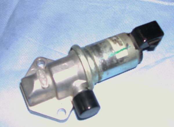

That is what this little valve does. A solenoid pulls in a pintle valve to vary the leak. Here is a diagram of a typical IAC valve
{FORD DIAGRAM GOES HERE}
Here is a photograph of that same IAC (it happens to be from a 1993 Mercury Sable, but for all purposes it is the same as the one in our Explorers….they vary only slightly in appearance and are the same in operation...sorry about the fuzzy pic)
The valve CAN get “crudded up” and with the non-plastic models you CAN clean them. One thing to remember is to remove the little plastic vent cap…if the felt filter in it gets wet with cleaner you will need to dry it out overnight or the IAC won’t work properly.
When you remove that little cap, BE VERY CAREFUL. Break it and you got a new IAC on your shopping list. So ... do not just pry on the outside edges of the big cap... Pry on the inner edge where it goes onto the tube. I found that something V shaped worked well – this was a door panel removing tool but worked like a champ…
I used brake cleaner and thoroughly cleaned the guts of this little baby…
dried it with a hair dryer and reinstalled.
When they are bad sometimes you will hear a fog horn or train whistle sound… sometimes your idle will be all screwed up. (I'll try and add more detail to this thread as time goes on - just wanted to get it up so I can fine tune it)

Mine used to do that, till i took off the lil black cap and lost it.. now it doesnt.. but its probably bad for the engine :x
They certainly can lean out a mixture, but the leaning would not likely be relegated to one bank only. More often than not a bank lean code is a leaking intake gasket or O ring.

There are 3 different types of IACs that ford used (I know this is a fact for first gens but unsure of others) one of them is servicable, the others are not.
The Idle Air Control (IAC) valve is used to control engine idle speed and is operated by the Powertrain Control Module (PCM).
Three types of IAC valves are released for use (Figures 1, 2 and 3):
l Hitachi (Figure 1) can be identified by a silver metal housing. It can be cleaned. (Refer to Service Manual).
l Hitachi (Figure 2) can be identified by an external vent/filter. Do not use cleaning solvent on this valve; to service this valve, replace it.
l Nippondenso (Figure 3) can be identified by a black plastic housing. Do not use cleaning solvent on this valve. To service this valve, replace it.

The first valve in the picture above has no filter on its side, as well as the last valve. I don't know why the second type is designed to use a filter. If the mounting flange, and electrical connector are the same on all models, why can't they be interchanged (or could they)?
I'm just speculating, but I think the vent will allow the IAC to respond more rapidly because it won't build up pressure behind the pintle. Of course the vent also allows it to do this:
