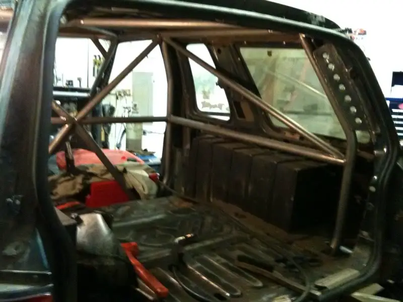

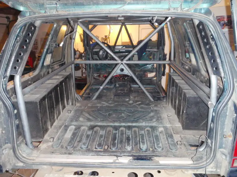

Thanks for the props Dannyboy. The idea behind plating the body to the cage is to unify the structure so that the body isn't flexing around the cage/frame. For starters it will be noisy and tend to rip apart the body. Plating the body in a bunch of spots makes for a more rigid structure. This thing isn't a show truck and putting a new body on it would be a major ordeal with how many spots the cage will go through to the frame and firewall, etc.
Yes the rear wheelwells are different lengths. At the time it was to accomodate the fuel filler. It was my first welding/fab project so it wasn't the most well thought out in process or execution. If I did it over I would make symetrical round ones, bead rolled and all that jazz, but as it sits they are in there and it was a PITA so I'm just gonna leave em, even though I'm not all that pround of them. I plan on plating the horizontal tubes between the D and B Pillars to the wheelwells with dimple dies after the rear shock hoops are in so it will look a bit more presentable.
There will be a fuel cell sub-mounted in the floor behind the rear axle, and the fuel filler hose will come up to an aluminum panel that will replace the rear driver's side window.

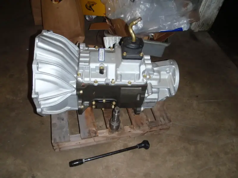

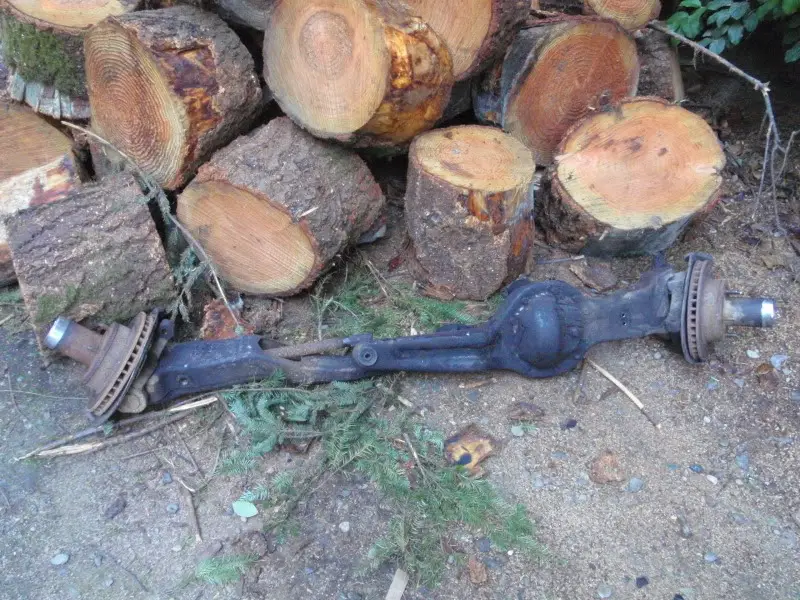

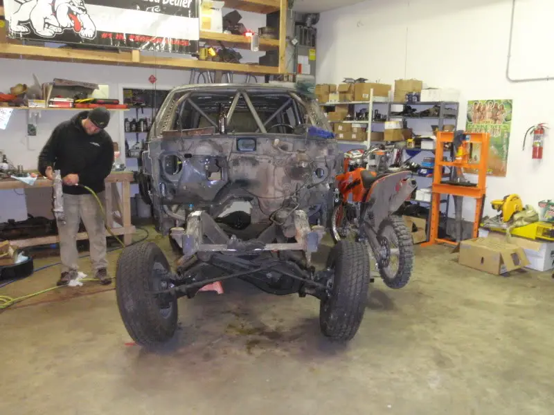

I tore some goodies off a buddies 80' Bronco last week. Just picked up the rear axle from getting a friend to sandblast it this morning. I will truss it and put new spring under perches. I am planning on removing all the D35 stuff, throwing my attempt at custom beams in the garbage and building new brackets to accomodate the D44 TTB and notch the frame and see what happens! Wish me luck lol. All I'm lacking right now to go forward is an NV4500 trans, which are hard to find used.
I'm going to hack off all the front shock hoops I built and build all new stuff the right way too. Sorry for the long post but it's been a while!!
I plan on sticking with my Deavers instead of linking it. This thing is going to be a fun truck with an ultimate goal somewhere far down the line of being a badass chase truck for a future race truck that I will build. I never got a hold of those bypasses but I will get my hands on some one of these days. It should be pretty capable with deavers, bypasses and 2.5x4 bumps
