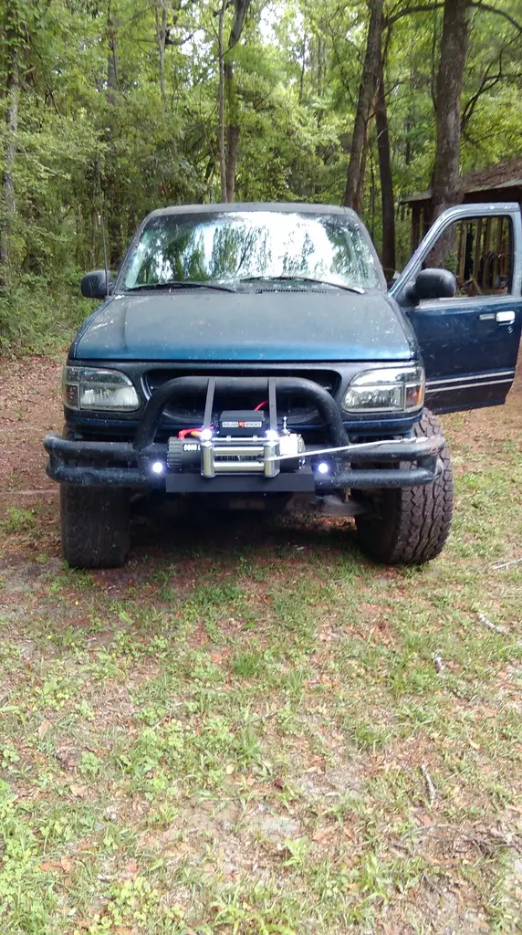

My parents bought the ex in 99. Many years later and thousands of miles later, it was handed over to me. I have had now for right at 6 years. Sadly I have no pictures of what it started as. This is the most recent before the bed liner paint 2 weeks ago.
I have really very little money in it. 3 inch body lift, factory torsion bar twist, rear spring shackles from a 68 land cruiser. Crystal vision headlights, custom front and rear bumpers, winch, rock lights around the winch 33 inch tires on 10 inch wide wheels. I had true dual straight pipes on it but installed a full walker setup when my son was born. Factory 8.8 rear axle with locker. Keep in mind this truck is only 2 wheel drive. With the added tires I did swap the front steering knuckles with a 4wd sport. I made a set of stub axles to retain the bearings. Right now the truck has 340,000 miles on the factory 5.0 and still going strong. So here we are to a photo dump. Please leave feedback, I'm always open to ideas and new changes
