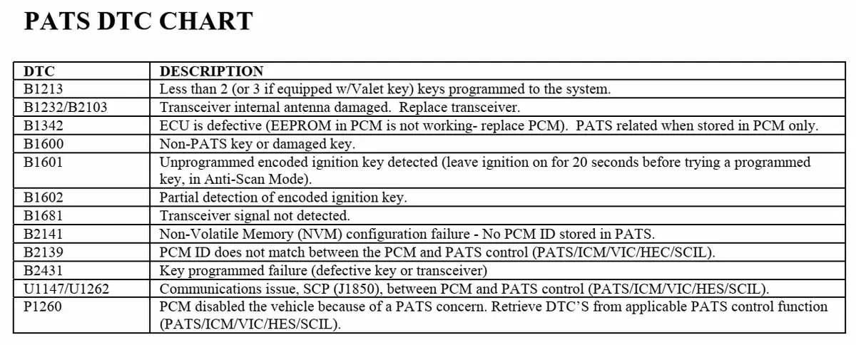

A compatible code reader and app (like Forscan) will retrieve specific codes for PATS problems. Here is a list taken from the below-linked topic:
The above linked post also has a pic of blink codes from the dash light, which may or may not help.

P1260, is the code that it gave me. But it only said "Theft detected engine disabled"
My best guess is that your code reader cannot understand the more Ford-specific codes higher up on that pic, that when P1260 is set, some other code(s) should be set too. A standard OBD2-only code reader may pick up the P1260 but not the Ford specific codes starting with other letters than P, which is where Forscan comes in.
P1260 and B1318, ignition voltage below 9 volts. That was both codes. Fun
