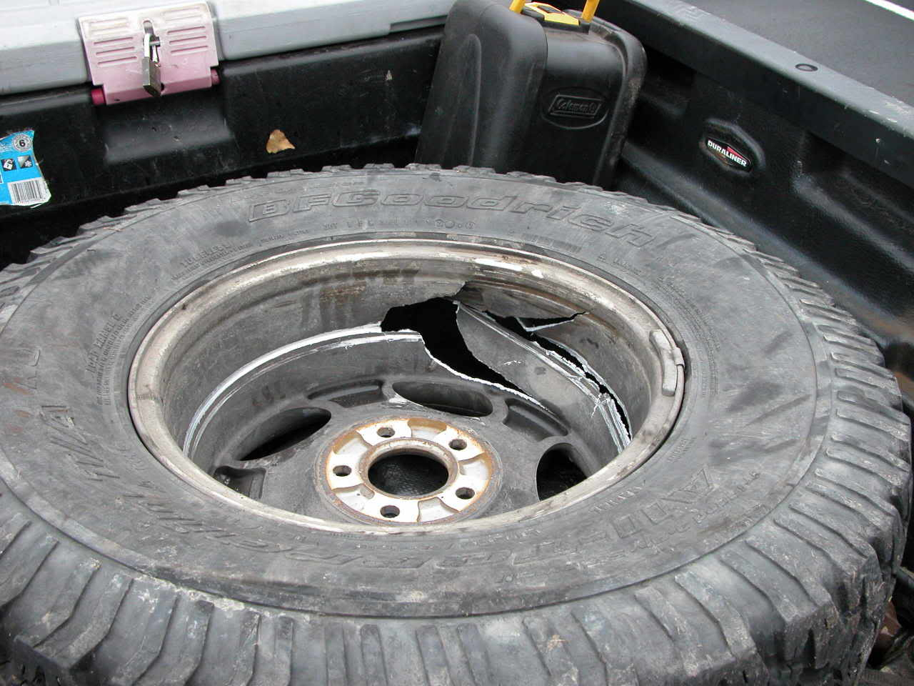

It happened again (same side, passengers) about 3 weeks ago. I was driving down to Denver and could hear this weird metallic rattle/clunk.
You can get to the two caliper bolts without taking the wheel off. Just turn the wheel hard to the left (for P-side, hard right D-side) and crawl under there to access the bolts from the backside of the wheel. I re-tightened mine in a gas station parking lot in less than 2 minutes. Its a 15 mm bolt, luckily I keep wrenches in the truck.
I need to get some Blue thread locker
