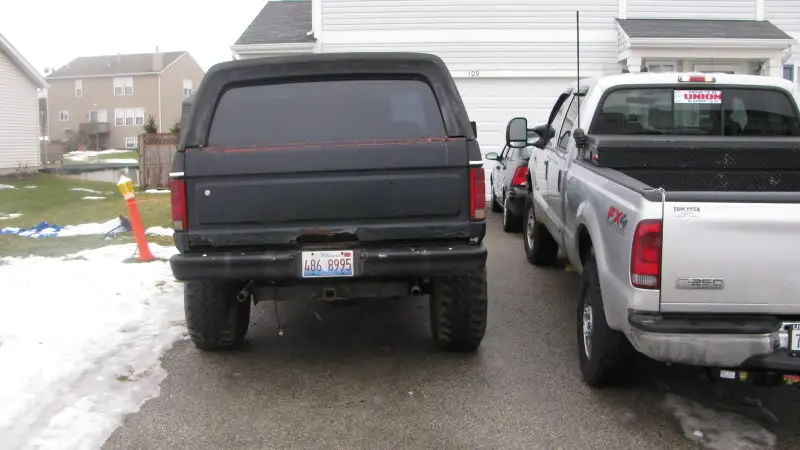

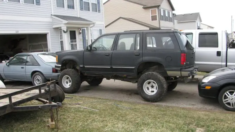

here is the explorer.

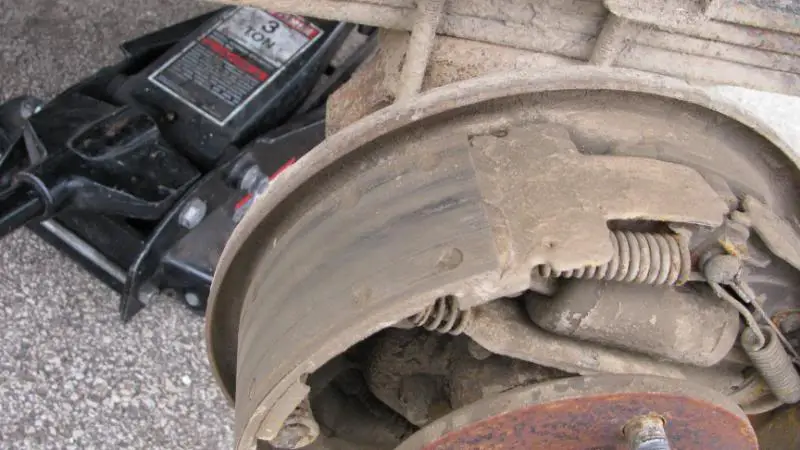

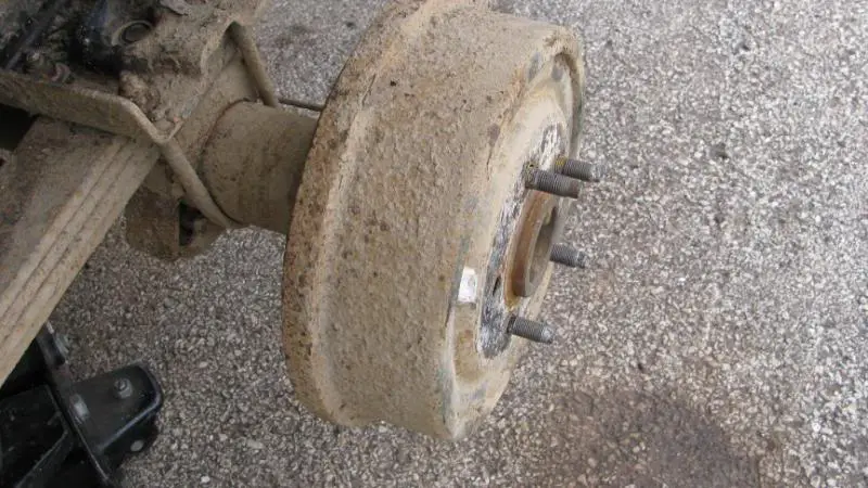

the brakes look big not sute what they were from?

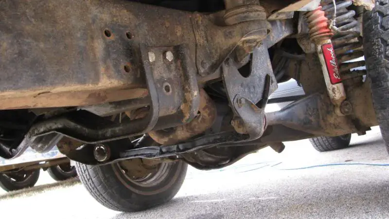

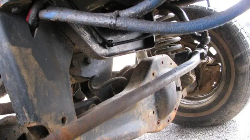

That's a Superlift 5.5" lift with the SOA brackets.
Those brackets "say" they don't need to be welded but if you don't, well, you can see what happens. Those tabs are supposed to hit the old spring pads on the bottom of the axle, but under load they can buckle and you're gonna break a drive shaft for sure.
Just get those rear perches welded up in the right spot, and you're good to go. If you wheel it hard, you're gonna have to put some gussets on the front drop brackets as well as they apparently start to break.
I'd pull the body lift, trim the fenders, and run the crap out of it.
Oh, and get some manual hubs...

The rear brakes look kinda wide and the front look like a pre 90s style slide type?
