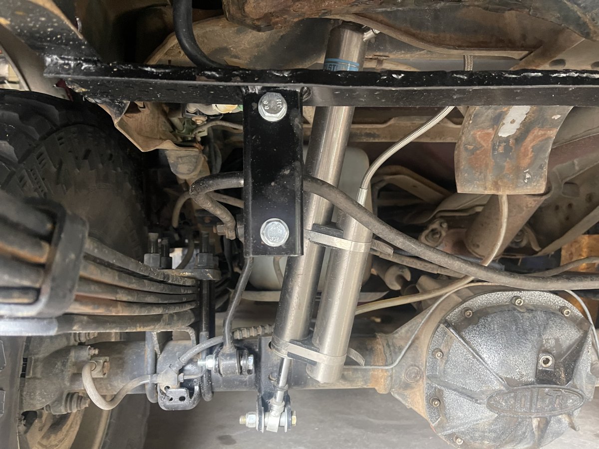

With my bump steer under control and with better shocks, my on road driving was pretty decent. But still wasn’t great. Ever since I got 35s (spring 2019), I have been running without sway bars. Works pretty good offroad (although a little tippy here and there), the on road performance was less than confidence inspiring. Now when I hit a bump (or a yump for you rally fans) at speed, the steering wheel didn’t move, but the body rocked back and forth excessively.
I’ve been looking at sway bar options. A Currie Anti-Rock would be great, but from my research, their shortest bar is still too wide for the Explorer’s frame rails. Not by much, but enough that some fabrication would need to take place in order to mount the bar’s end supports. While this issue isn’t dead, I decided to focus on a rear sway bar instead.

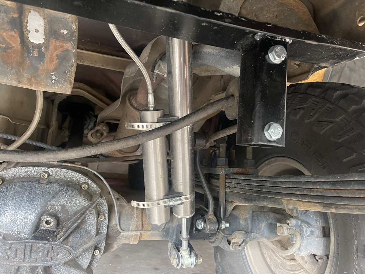

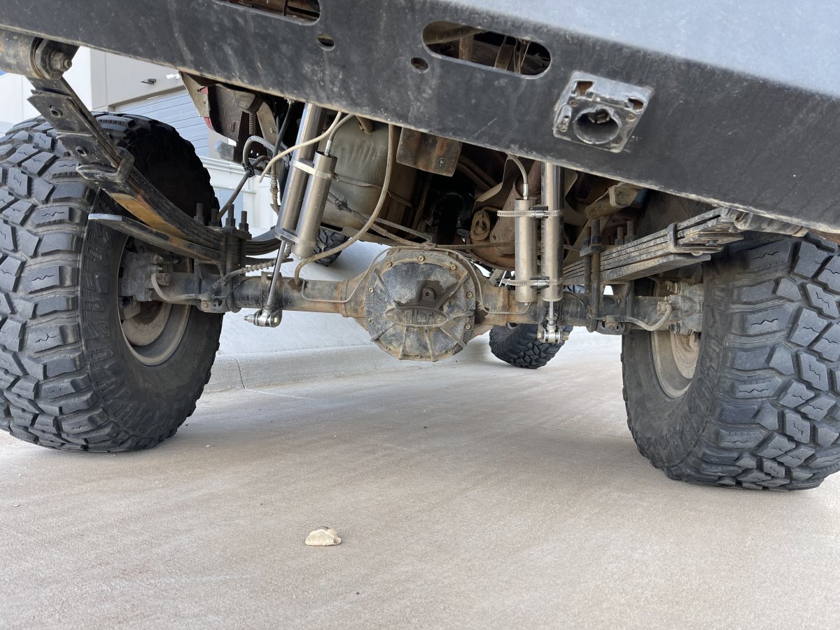

Problem is, my rear axle doesn’t have much room for a factory sway bar anymore.
But, a factory sway bar has a width that works great between the frame if you attach the end links to the axle instead of the bar. So I got a sway bar from a ‘98 Explorer. There are some minor differences over the years, but I don’t think it matters much for what I’m doing.

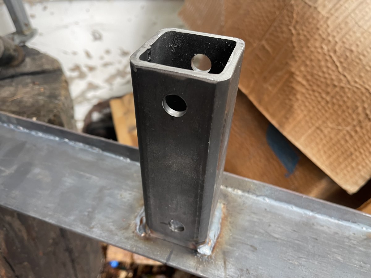

I designed a plate that goes between the frame rails that has 2 drop legs to mount the sway bar bushing attach brackets to. And of course I welded on some attach points on the axle.
The result is great. So much less body roll on the street. It’s easier (and safer) to drive now. It’s less fatiguing. And the offroad performance hasn’t been hurt- it may actually help with traction. A front sway bar might be in my future as well. Need a thing or 2 before that can happen.

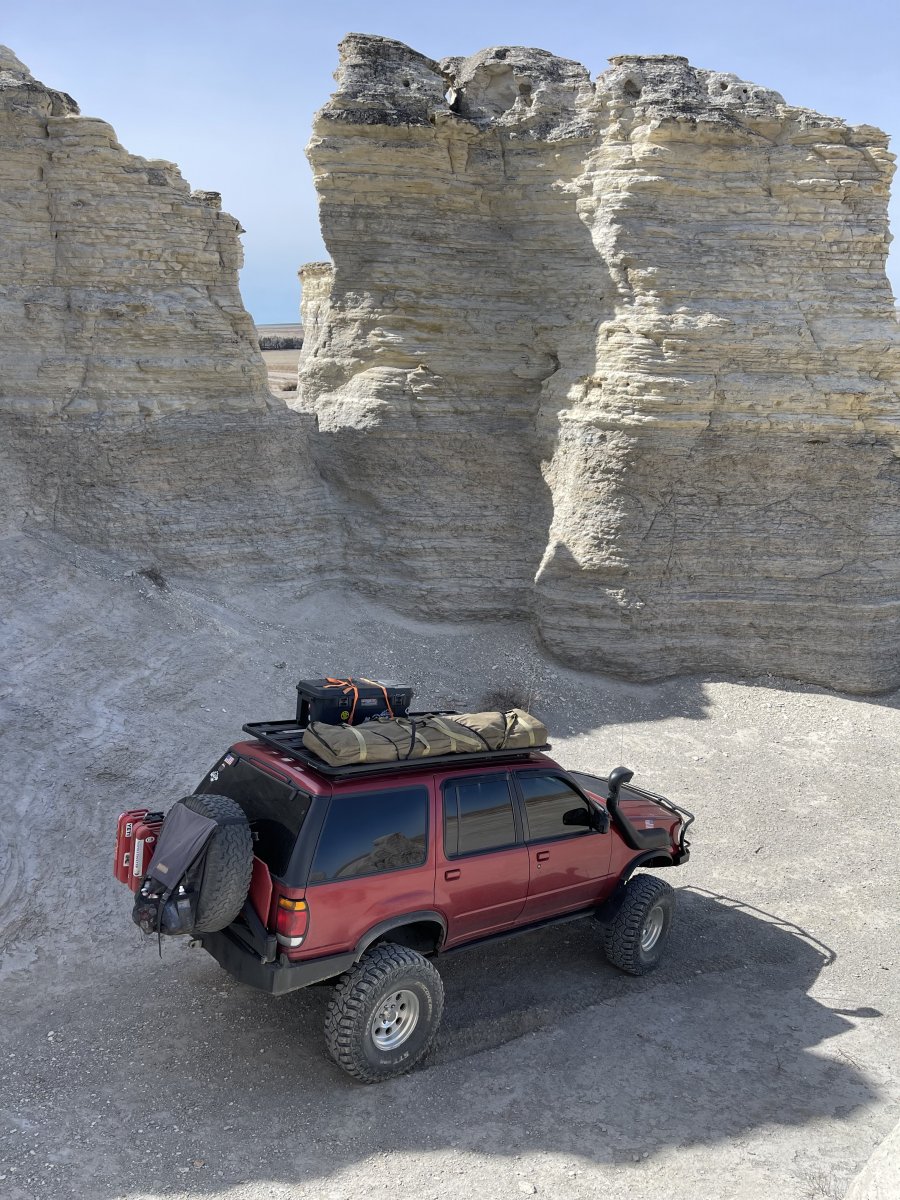

The next day was just back home. We did stop at Monument Rocks near Oakley, KS. Pretty cool.
