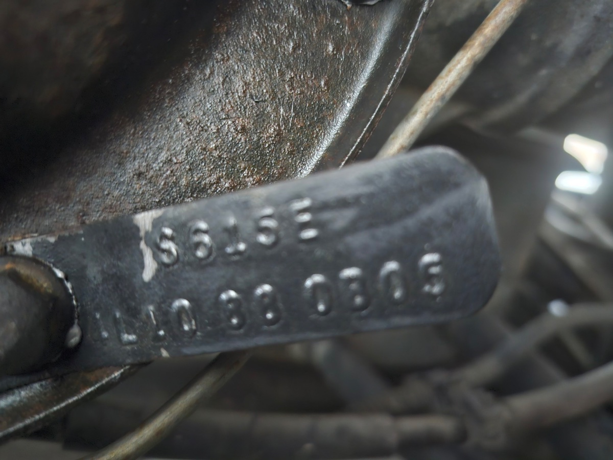

That’s good to know - thank you for your help. I was starting to get worried. I do have a question though - when you said it’s and open differential and not an LS - is the LS for Limited Slip? Because the tag on the differential housing said LS on it so I just wanna make sure.
^ What else is on the tag? These might be the codes:
Also you can get your VIN and input it on the VIN lookup site linked in my sig to see what it's supposed to have, for example my '98 shows:
Axle Front Rear Wheel Drive 1
D042A
Axle Rear RWD
3.73 Ratio Limited 8.8 Ring Gear Parts List 26
D042A
Axle Rear RWD
Thank you! The Im gonna attach a pic of the tag but I’ll also write what I THINK it says:
TOP LINE: S615E
BOTTOM LINE: 4L10 88 0B05 (the B might be an 8) / (that last number is possibly a 6. It looks like a 5 but it kinda looks like a 6)

Then it’s a LS. Actually, I think the open and LS diffs should behave similarly in this regard…apparently they need torque input from the driveshaft before they start doing their limited slip thing. I could be wrong though…I’ve never rebuilt a LS rear
