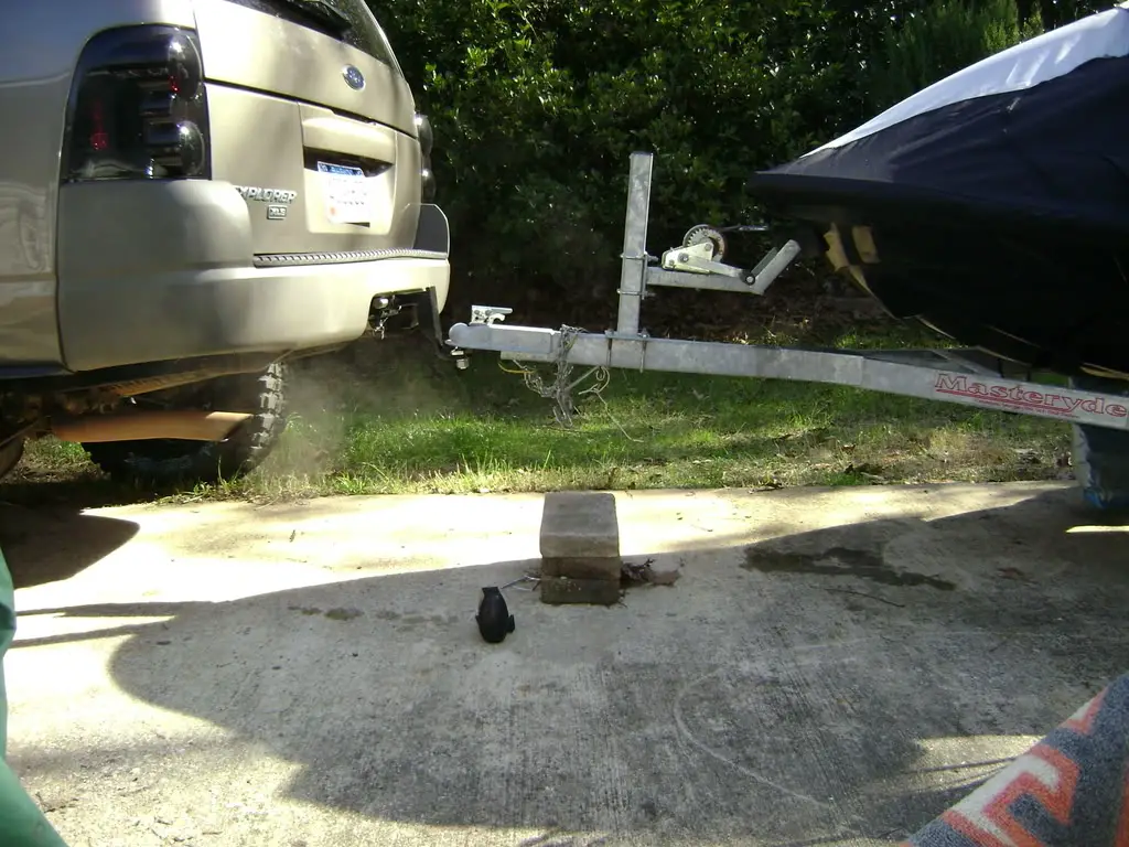

hello...i just lifted the ex and bought a 6 inch drop hitch...does this look safe to tow? ive always heard its best to tow on a "safe plane" and its not level at all...will it be ok? and ideas or recommendations?
If thats just a personal water craft, then its probably fine. Just dont forget to put a pin on that ball latch.
I would almost try and find one that drops even lower normally you want it to sit level or have the trailer pointing down a little, but if it only weighs a few hundred pounds then it is probably fine.
That's still only a 7-1/2" drop, and a 2" drawbar... he's already got a 6" drop and a 1-1/4" receiver... Won't work.
He needs a bolt-on receiver. While it'll look weird having the double receiver setup, functionally, a 2" receiver bolted below the factory one will help out. It'll get you another 4-5" of drop. Combine that with the afore-mentioned adjustable unit, or a regular ol' 6" drop mount and it'll work just fine.
As mentioned, on a single place jet ski trailer, it probably won't make much of a difference either way. But I'd want it a little closer to level than it is.

That hitch will work fine for what you have hooked to it.
