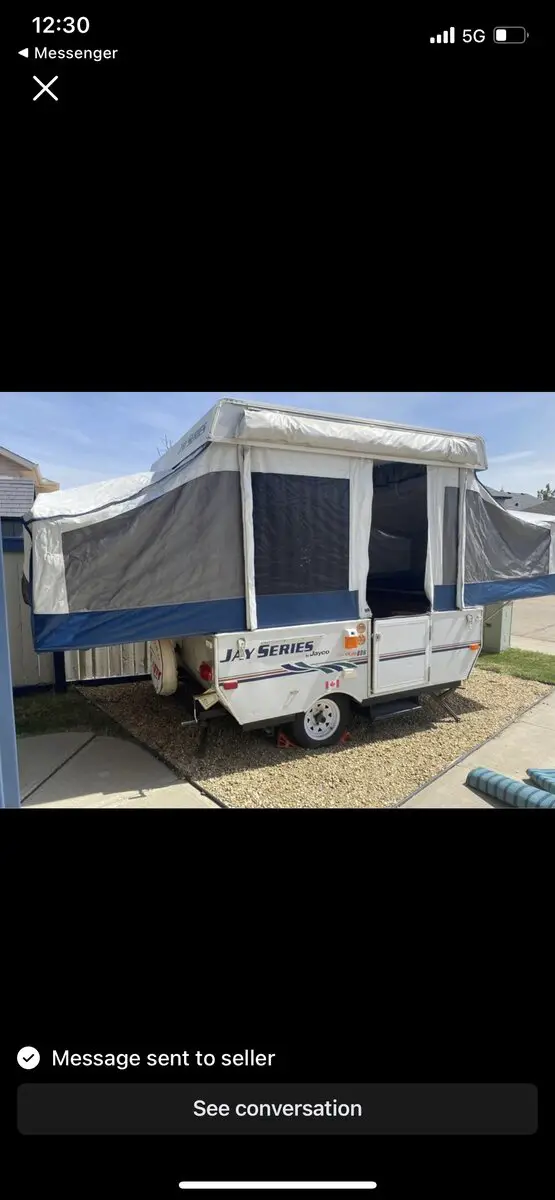

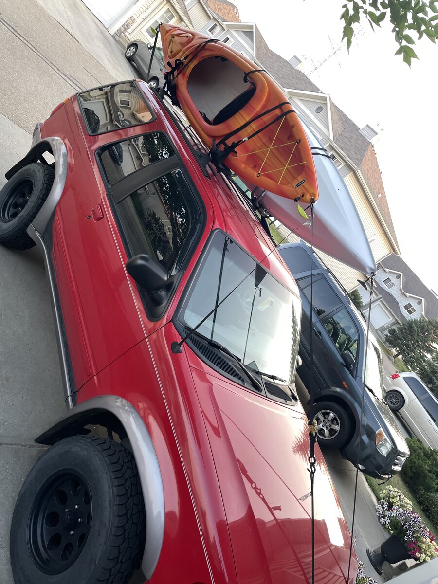

Thanks everyone, bought a used 1450lb trailer. Forgot to mention my 5 speed manual has a reman. transmission that was put in under a year ago. Only “rough” terrain will be pulling off the side of road to get down to camping spot.

alright!!! just watch your speed, keep a following distance (ie. dont tail), ad it should all go fine! have you still got the monoleafs out back?
I added helper springs and beefier suspension at the rear.
that should help then! in the future, maybe look into the 4dr leave if you plan on towing the popup semi refularly, as they are much better than the monoleaves
