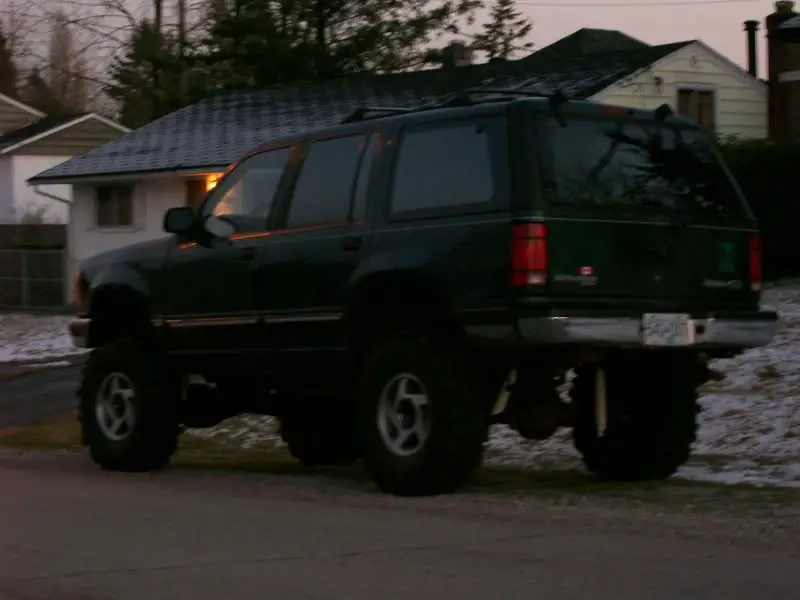

Its very straight forward, the only thing I can say is make sure you put the leafs on the right way! I made the mistake of ASSuming that they were the same either way they went. I bolted everything down and put the tires on and noticed that the rear axle was about 1 foot extended toward the rear of the truck!!!!!!!!!!!!!!!!!!!!!!!!!! I went to pull the truck ahead a few feet and the drive shaft fell out,.... this set me back a good 4h's

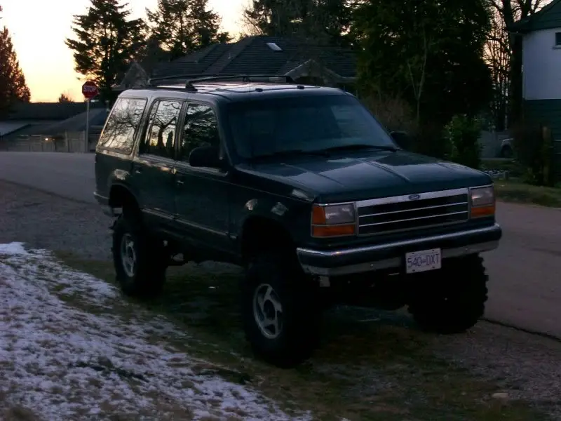

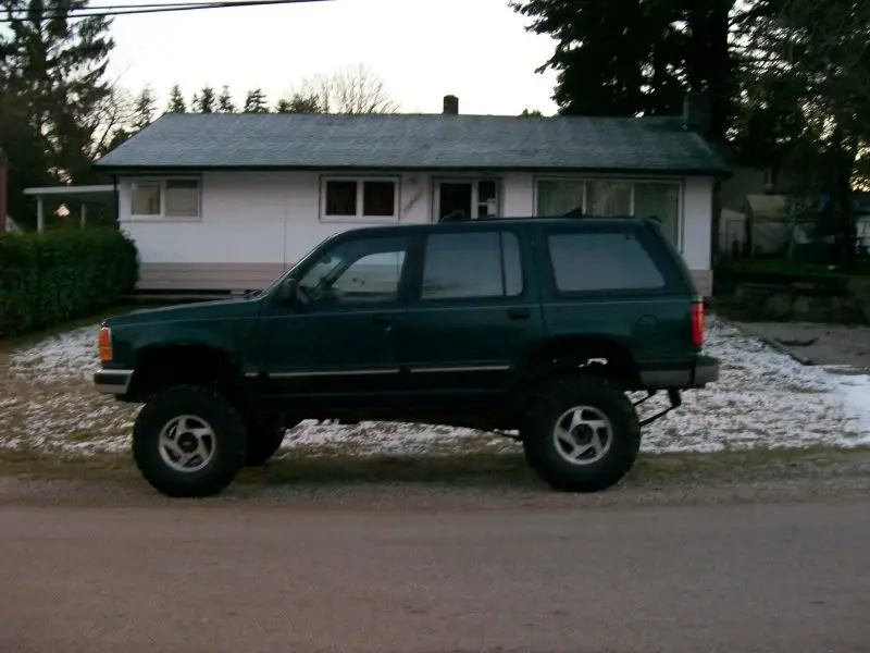

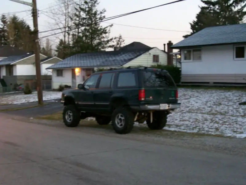

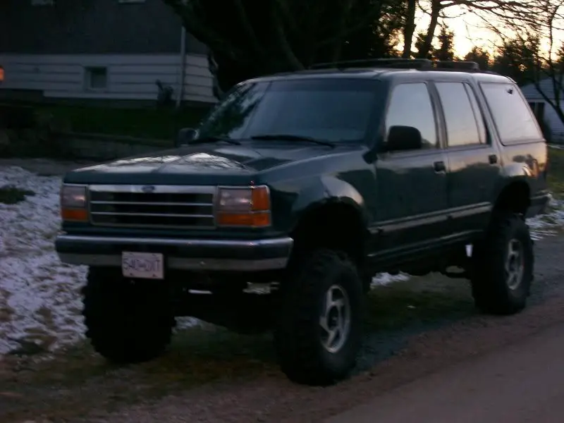

all done and said it took me 22h's on a 3 day weekend with no help at all.. I did have a inpact gun witch was a HUGE help. And after the lift and shocks and brake lines it came too $1100 CDN
here it is done
I will post some better pics of after, and of some wheeling this weekend!
any questions or tips please add!

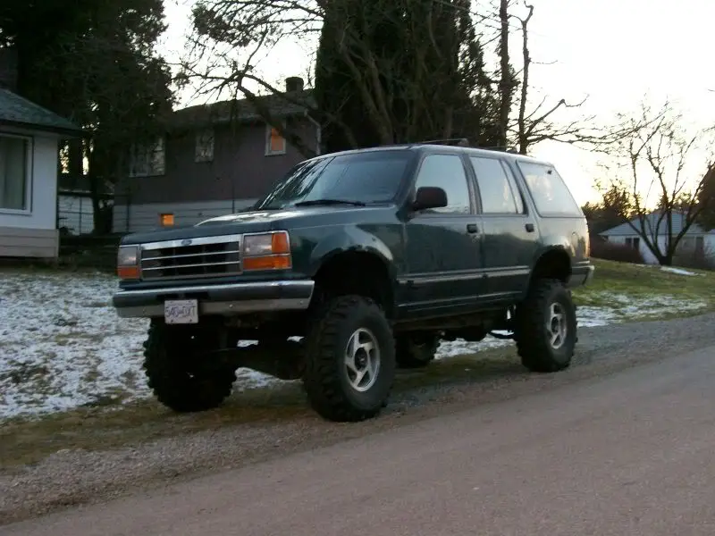

it rides very well. MUCH better than before. before it drove like **** due to the radius arm bushing being so shot.
I also had no help with this, its not so hard balancing the axle alone when you are putting it on, other than the radius arm brackets!
I drove it on the ramps today to see if anything was getting in the way before I go wheeling tomorrow, seems ok. Body is nice and straight when its on the ramps, will take some pics of wheeling tomorrow :)
