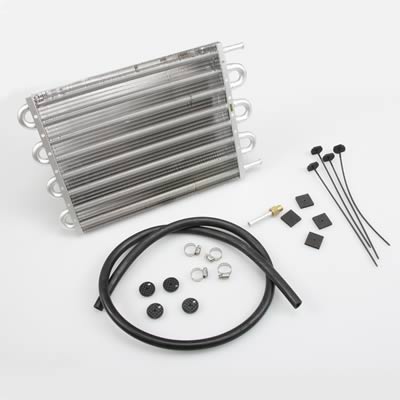

Here is what I am looking to install:
Summit Aux. Transmission filter (Summit Racing # SUM-G4980)
Summit Transmission Cooler (Summit Racing # SUM-G4962A)

All you have to do is cut the hard line, about 4" after it comes out of the radiator and turns 90 degrees. Flare the end and run a rubber line (high temp trans cooler line) with hose clamp to where you want to mount your new cooler, run it to the top which will now be your inlet.
Where it comes out of the coooler now run a rubber hose over to the pass side frame rail, cut your hard metal line in this spot again anf flare it, attach hose and BLAMO you are good to go.

Getting back to your original question about plumbing a remote filter and aux. cooler. The easiest way to ID the lines is to locate the hard line that enters the top of the radiator. This is the line that carries hot fluid FROM the tranny to the radiator. The bottom line carries cool fluid TO the tranny. After much discussion (on these message boards), I decided to install my remote filter in the line FROM the tranny BEFORE the raditator (I'd prefer to keep any debris out of the radiator and aux. cooler). Yes, I used a mini-tubing cutter to remove the elbow in the hard line (as the line turns toward the driver's side of the vehicle - between the radiator and front cross member). The remote filter base is mounted on the frame rail, just in front of the sway bar. Again, after much discussion (here), I've decided to install the aux. cooler after the fluid goes thru the radiator. So, I will using the mini-cutter to remove the other elbow in the line TO the tranny. The fluid will then be routed to the aux. cooler and then back to the TO line (return to the tranny).
One Forum member accidentally verified what some of us have discussed in-depth; if you put the cooler BEFORE the radiator, you can actually heat the fluid before it returns to the tranny. The radiator uses a fluid-to-fluid heat transfer method. So, if you're coolant is hotter than your tranny fluid (as it comes from the aux. cooler), you're tranny fluid will exit the raditator hotter than it entered (not good).
To re-itereate the loop: Tranny > Filter > Radiator > Aux. Cooler > Tranny
