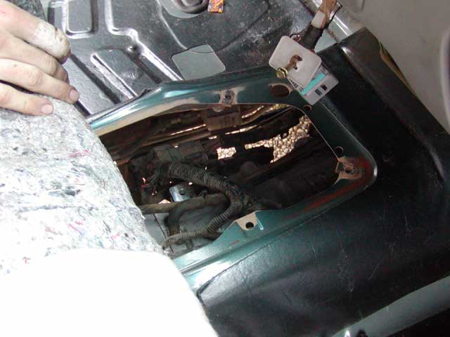

Dropping the exhaust and going through the wheel wells can also save time doing this....
Pull the front seats out and go through the floor.
Thanks all, I knew there had to be a secret..... hatch!
