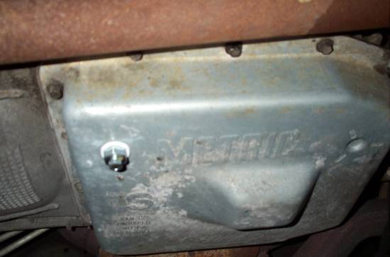

I use a 5 gal bucket.
B M Trans drain plug. Got mine at AutoZone.
