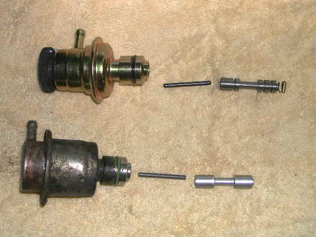

One thing that I forgot to mention is that there are 2 kinds of pins that could go into it. I saw the pictures in Glacier's gallery. It looks like one is a little smaller, and the part inside of the case is different (that piece where the pin pushes against).
This is the picture that I was referring to from Glacier991's photo gallery:
Yup... that's the problem... my original one was the bottom pic. The replacement one they gave me at the parts store was the top one. Problem is, it doesn't come with the adjustment knob, but it has the threading on it for one. Is this gonna ruin my tranny??? I've been driving like this for 2 weeks now. I hate it when they give the wrong parts.
