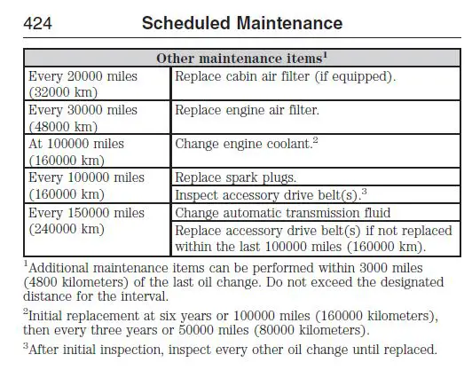

Page 575 of the 3rd printing in the Scheduled Maintenance section.
Every 150000 miles
(240000 km)
Change automatic transmission fluid
Replace accessory drive belt(s) if not replaced
within the last 100000 miles (160000 km).
Peter
For me, that should be the third time.
