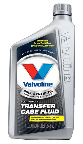

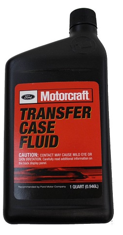

What transfer case fluid you recommend? The delaer told me they no longer sells Mercon and to use Mercon LV.
I read that you can use the Valvoline multi-vehicle transfer case fluid or mobil1 ATF. Will either work and be a better option than Mercon LV?
I just want to make sure I buy the correct fluid. Thanks

Sounds like the dealer wants you to destroy your transfer case so you'll buy a new vehicle from them which is what Mercon LV or Mercon V will do.
You're going to want to find one of these two:
View attachment 322337 View attachment 322338

Thank you for the information!!
I can't find the Motorcraft but the Valvoline is available at Advance so that's what I'm going to buy.
