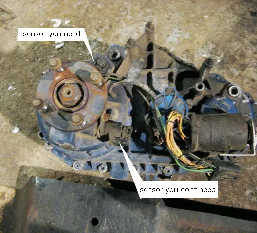

The sensor at the very back of the transfer case.. its near/under the rear output flange. There should be a few wires coming out of it.
Ok i know there is a few wires coming out the back that run to the transfer case motor (actuator). Where do those wires you speak of run to ??
This one -- right under where the rear driveshaft bolts to.

The 97 case also did not have a yoke at the front of it -- it had a cup-looking flange for the CV. If it is a 97, then it will be missing the sensor in the picture. Ask him if the transfer case has a sensor right under the rear output flange - as in the picture above.

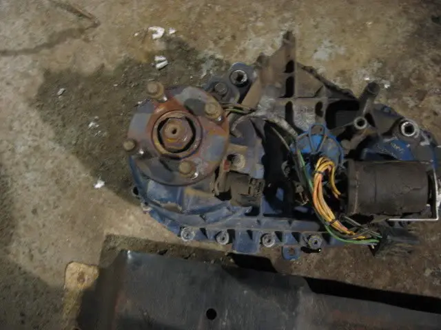

here is a couple pics of what he has:
Its hard to tell from the last pic because its taken from the top and what we want to see is the bottom. Ask him to take a pic of the rear flange head-on

ok the guy just sent me a pic of the case and ok i just looked, it has that little sensor behind the rear output shaft flange. So that means it would be no good to me RIGHT ??
That transfer case will work -- the sensor is there.
One thing that I do find strange is that this transfer case also has the analog/mechanical sensor on the side -- which you dont need and can ignore.
When you get the tranfer case in, take a few pics of its tag and/or plastic stickers on the body -- my guess is that this is probably a late '97 transfer case (which some one painted blue for some reason :D).
