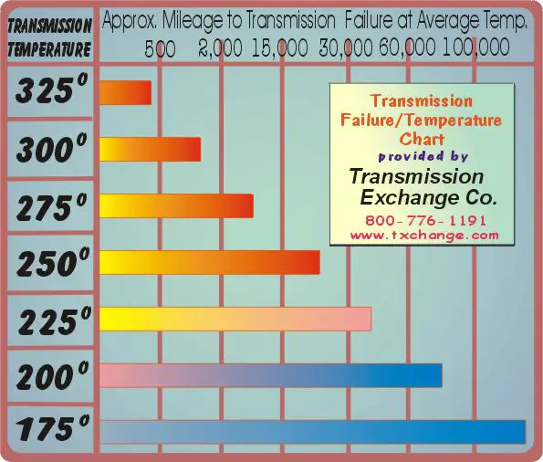

Why Not, the guys talken -41 degs, at that temp his tranny will never see 110 when the car is running warm.
Heat is what usually helps destroy a transmission. I don't think ATF will coagulate like engine oil.
BB, what I am saying is, at -41 degs, the guy will never see tranny destroying temps.
I monitor my tranny temps (do you?) mine are always in the 145/170 range.
Auto trannys are made to run at certain temps, is info on the web that states that temps below 130 can be deleaterous to both the tranny, and gas mileage.
In some cases, cooler is not better.
