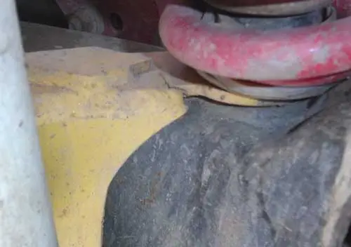

FWIW, I had a Stupidlift arm break after a mere 8 months (Not sure which was worse, them or the Rancho... At least the stock tires don't rub on Superlift).
I fixed it by plating it as already mentioned above (sorry, no pic, but just imagine grinding those worthless diamond-shaped pieces off the ears, placing 3/16 to 1/4" thick plates on them and then welding it all together around the sides). The rest of the arm is pretty beef, but the fact they used 3 welded strips of metal to form the arm leaves the ears extremely vulnerable to these kinds of failures.
Fortunately I caught this side before it broke all the way off (always good to look under your vehicle once in awhile before heading off to the trail ;) )

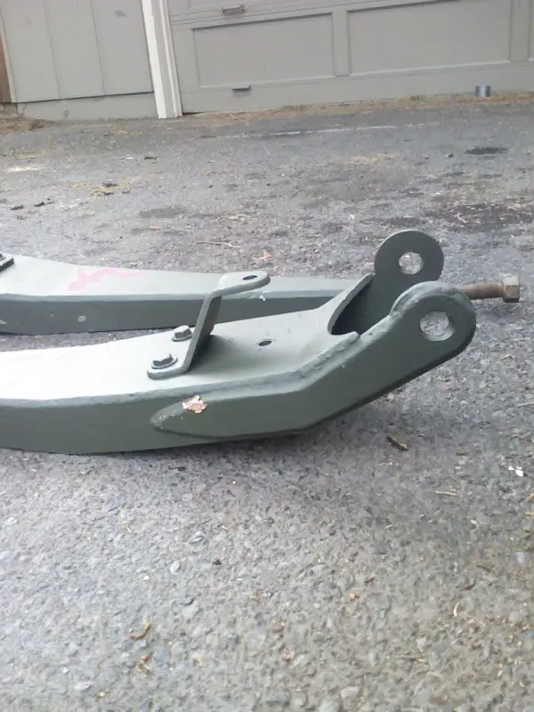

here are my arms. would 300 obo be decent or too high? i've not looked into these.
IMO $300 is a tad on the high side for just the arms since you can buy them brand new for $150 a piece from 4wheelparts.

..RangerX, that drawing/sketch at TRS looks just like where mine broke..:(

Anyway, I found a pic of repaired Superlift arms I was gonna post up here, but the ones 91ROKKRAWLER posted are exactly the same, so there ya have it ;)
