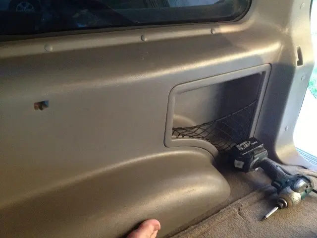

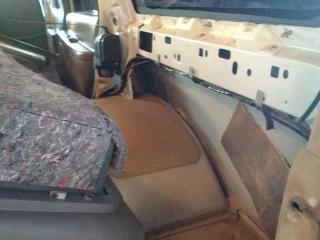

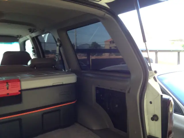

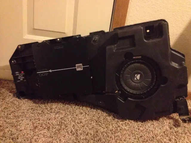

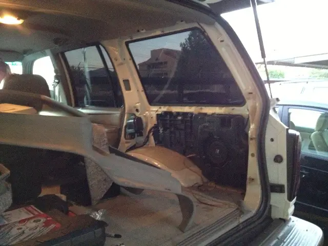

I have been busy with the whole house buying process so haven't played a whole ton seeing as we are saving money for the few things we will need for the house like a fridge and things. But Even though that's all been going on I have added a factory sub to the truck. Found an enclosure in the junkyard and so decided to set it up in my truck. Not after monster bass or anything just a little filler. So this fits the bill since it is all out of the way as well, still have my full cargo area. Cheap Duel amp and a nice Kicker 6 1/2" sub rated at 150RMS 300peak. Sounds really good believe it or not. I used to run a monster Eclipse 12" with 1500RMS but with the family etc no need for that so sold that earlier this year. Also almost done making the speaker cover, will look awesome and can be removed from the cargo area if I need to change any amp settings. Anyways here are the pics.

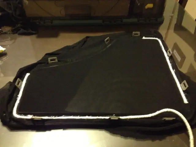

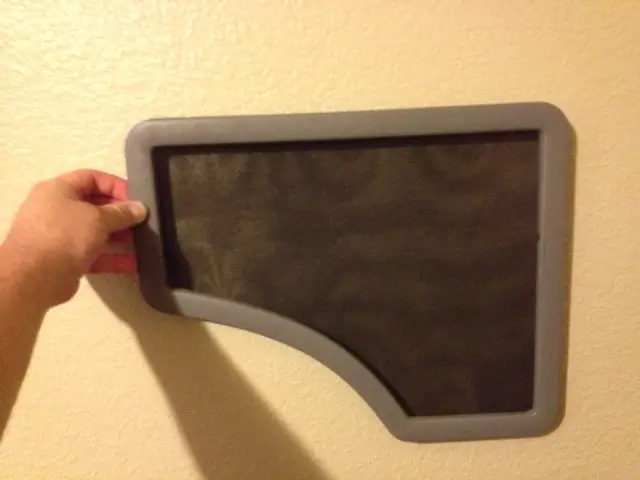

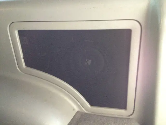

Finished the factory sub cover. I found some nice stretchy fabric and some rope and it turned out really nice. Like how you can see through it yet its not see through. :) Also if you look in the pictures I heated up the tabs and bent them all over. This way you just have to tuck in the tabs when putting it in the truck and it stays nice and tight, but if needed to make amp changes etc you don't have to pull the whole quarter trim, just pull out the cover.

Nice job on the sub cover, will try heating the tabs. I didnt install the clear securing tabs when I installed mine, cover keeps falling off during driving. Planned on using velcro but that would be difficult to remove cover.
