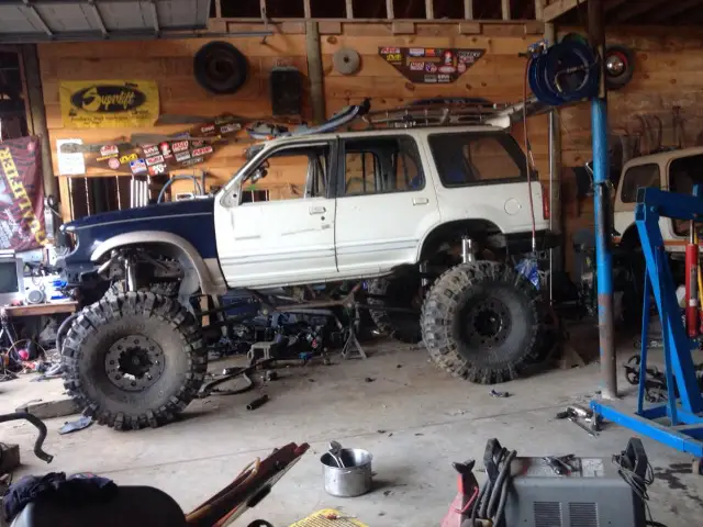

xeek's full width sas

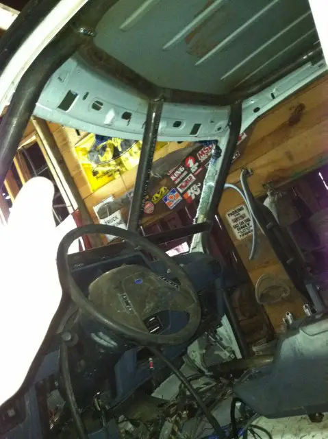

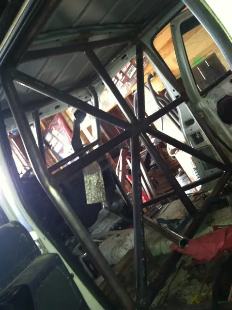

Cage

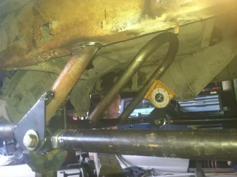

Rear driveahaft hoop

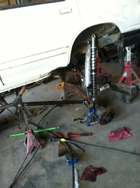

Little flex

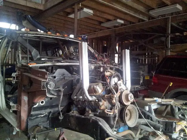

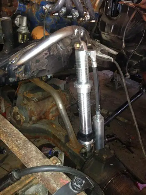

Headers ;)
Front hoop

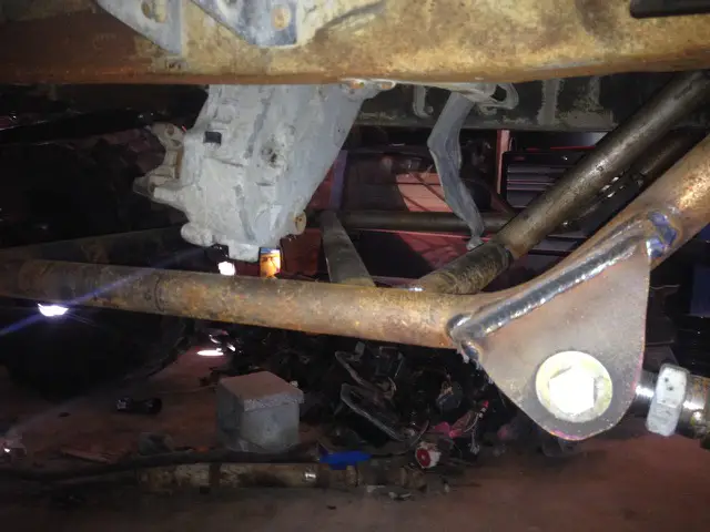

Belly bars

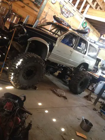

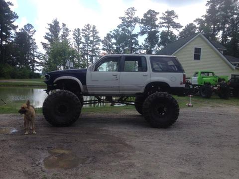

On its own weight
Full view
Great progress man. Those header might make it a bit hard to hear your spotter or anything else for that matter. LOL

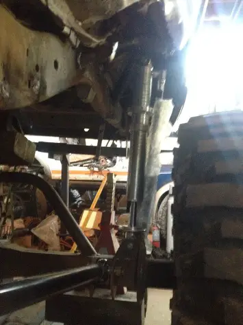

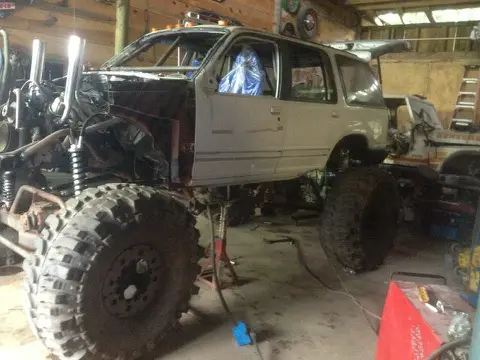

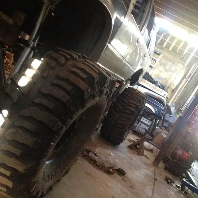

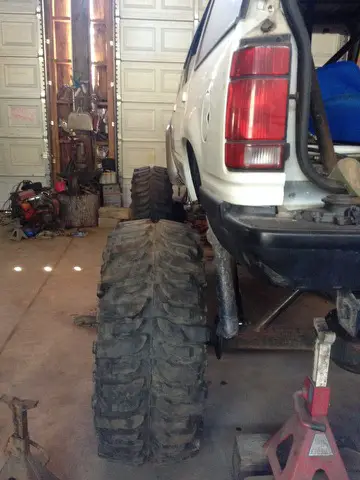

Sittin on all fours. Suspension fully welded. Currently has 3" up travel and 11" down travel. Need to adjust the collars. Looking for a final 8" down/6" up.

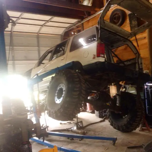

Little bit of flex. Got plenty more left to go ;)
Just need to cut and weld up the lower bars for the cage-to-frame. Run all my wires, get the fuel system connected, and do the steering.

That rig is a beast, how big are the trails where you live? It wouldn't even fit down the access roads to the trails here, damn. Keep up the hard work man, it's really starting to pay off. Those axles look small with the wheels and tires mounted. Lol
Just think of it like this: most of the buggies running 2.5's are hitting the same trails some of us are. They always manage just fine.
