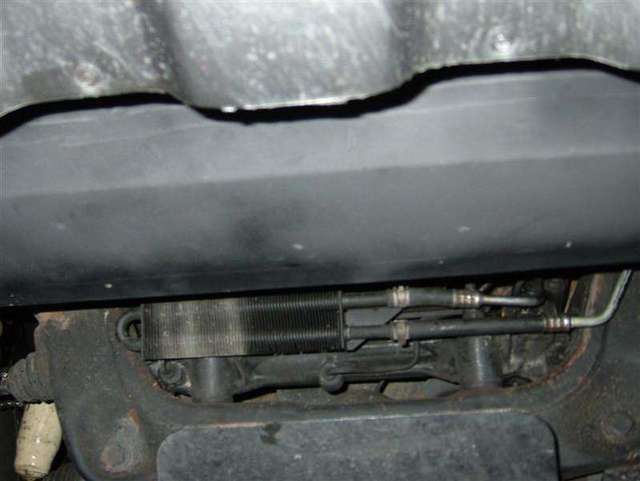

Where are the PS lines under the truck? Sorry, guess I need to buy a Chiltons.
In the center of the truck right above and in front of the crossmember is the PS cooler. There are two hoses that connect to a U shaped cooler. These are slip on clamps, you just need pliers to undo them. When you turn the wheel, it will make a mess, you should try to capture the fluid somehow.
You can see it in this pic. Your truck won't look like this underneath, but you get the idea...
