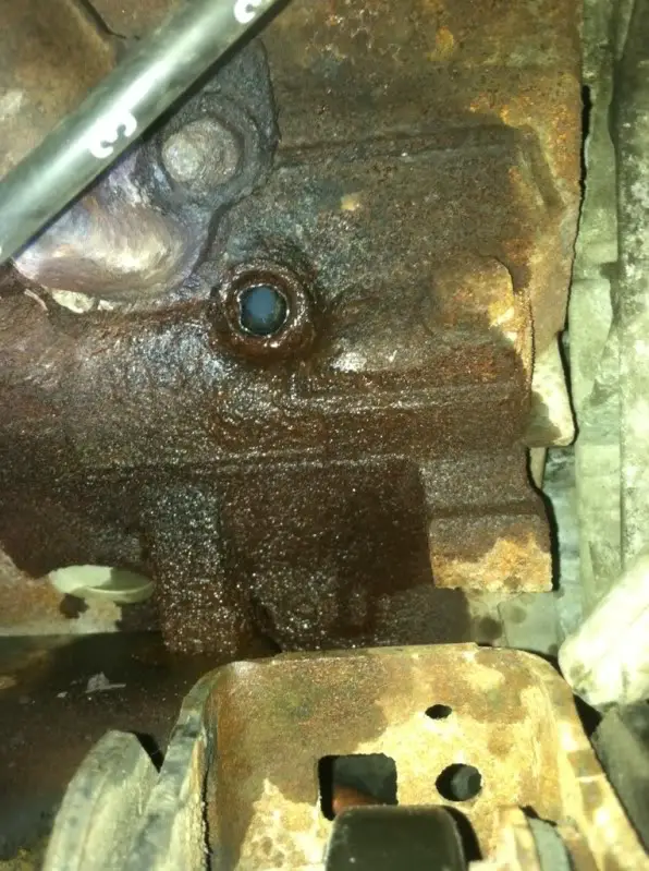

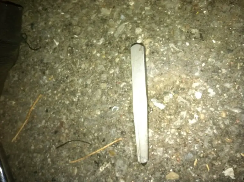

wow ,the ez-out went right thru the plug ,did the remnants of that plug fall into the engine i wonder??
Tadaaaaa!
Also got plug 3 out with generous chiseling away corrosion around the hex.
Now.... What to do about this....
I guess I'm in a better situation than I was 24 hours ago.

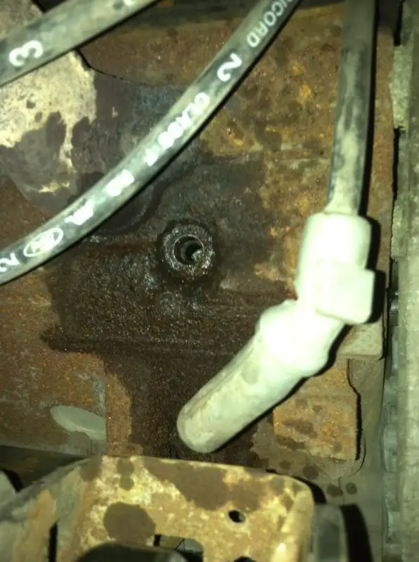

Awesome work, I'd be leaning towards a really high quality easy out... lots of PB in there first, clean around what's left there first to help it come out.
Got that craftsman set ordered for pick up. Might give it a shot tonight but it's chilly!
Thanks to this guy:
I am SO CLOSE to having it out!
One problem though it just reached a point and kept turning without moving - I bet it's stuck somehow... thoughts?
drive something in between the head and the plug like a thin punch to bend it a bit so you can grab what's left with needle-nose?
well I got the remnants out - the threads were toast. Time for an insert!
Yep, I got some inserts too now...
Carefull with the junk that falls into the heads - crank it first with no spark plug in, so the trash gets pushed out that way, instead of thru the valves.
Yep I have cranked it without the plug in and also put in a magnetic tool to get crap out as well. Hopefully my insert goes well today so I can get some new treads put on Monday :)
