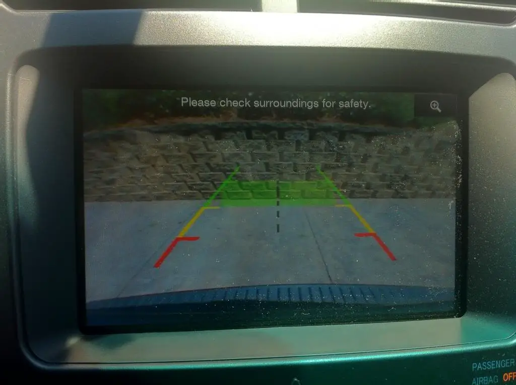

Hey guys, I banged the back door where the backup camera is, body shop had to order new door and strip with camera in it
Now, the camera points down enough so that the bottom inch of the screen is showing the bumper and the objects are distorted because it is pointing down more than it should be.
But, they have put in BOTH The new camera/strip (the camera comes in the molding) and the old one and they BOTH point in the wrong direction, so my opinion is the DOOR is different enough so that when they put in the part that has the camera, it points down and eighteenth of an inch more than it did with the old door...
Add to that the OLD Camera is showing the parking aid lines and the new one isnt, this is ODD since I wasnt aware they existed in the first place, those parking aid lines are new to me and the car is 2 yrs old, I have had it the whole time.
Anybody have any ideas?

this is also showing that strip at the bottom, why didnt mine show that for 2 yrs?
Mine has always shown part of the bumper.
You can change settings for the lines I think.. make them go away or appear.

Mine looks like Bryce's.
The one in the video looks like ours too.
Not sure why the OPs didn't... different camera or a bad original install.
mine never showed that strip at the bottom, and now that it is doing it sure seems the objects are distorted more than they were...are the lines new? or were those always there
yup ours shows the edge of the bumper too...

Like the others, mine has always shown the edge of the bumper. It is supposed to so that it helps you judge where you are in relation to fixed objects on the ground or behind you. The guidelines are also supposed to be there. If you have Active Park Assist you will also have the moving guidelines. Perhaps you never had that guideline setting turned on in the options.

Yes the bumper is in my bkup cam, and is the area of zoom, when zooming in the camera. Helps you know how close you really are.
I roughly measured the last 2 grid line areas once, the red/yellow zone is approx 3' away from whatever is behind your bumper.
That looks normal to me. As long as the camera isn't slanted. I see my bumper all the time and it helps me to really back up so close to my van in the driveway since I need extra space. Parking an inch apart to the car behind you when reversing has never been easier. I think if it didn't show the bumper, it'd be a PITA to get yourself really close in in a parking space.
