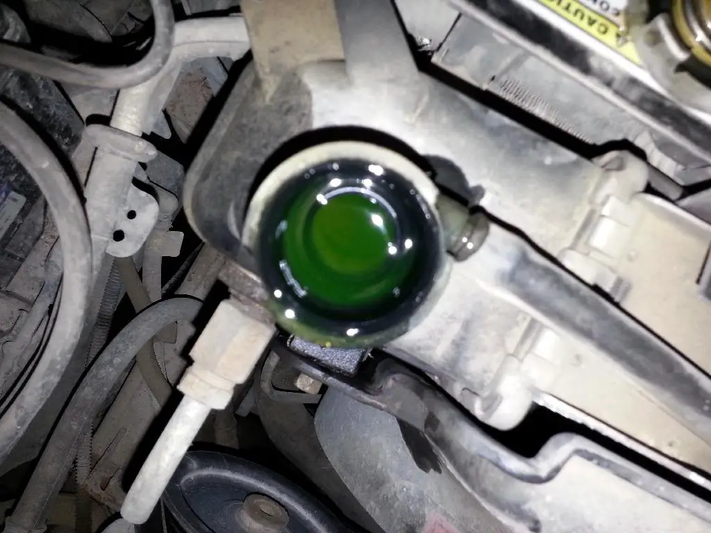

I wonder if engine coolant went to the transmission via the internal radiator cooler-how does the coolant level look? does it look oily?

the coolant is still green and full so i dont think that the rad cooler went.
