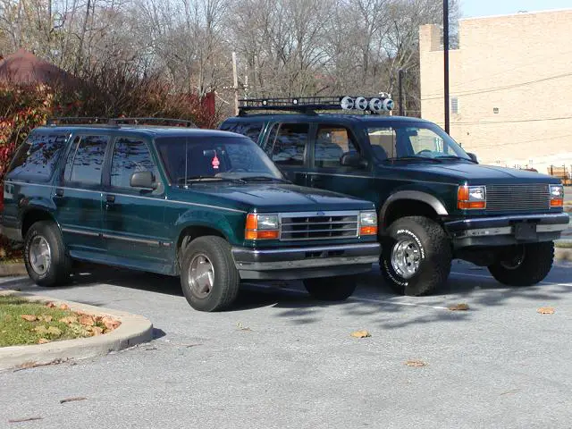

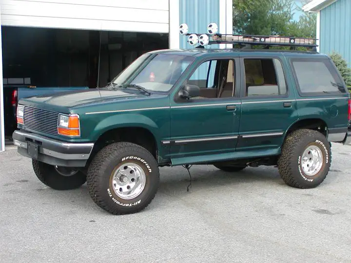

with 33 x 12.50 and 5" lift. more lift on the way....
roof rack, and lights mounted, billet grille and diamond back headlights.
eagle 15 x 10's with dirty tires.....
waiting for trans to button up hanging wires.....

Nice setup that you are going to have...Im also going to be doing close to what you are doing. What kind of lift are u getting for 5"? Awesome looking truck. So has your turning radius gone down quit a bit? Do you rub a lot with the 15x10's?
3" pa body, 2" donuts in the front, and Pro Comp springs in rear.
if you run this setup, it WILL NOT even come close to clearing the fenders with these tires / 15 x 10 wheels. its not just a bit off, its ALOT off.
I got the tires cheap, which started this whole project from an exploder with a bad trans......
stay tuned for more pices with more lift. Dual steering Stabilizer just arrived, along with SOA brackets from Brett, more on the way!

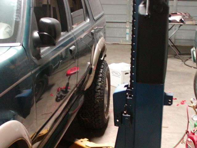

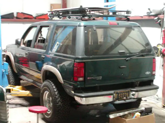

here are the Deflecta shield flares from a 97. you have to remove your mouldings from the 94's, as the door moulding doesnt line up with the flare, and the front fender moulding is in the way.
this is how i got them off of ebay, already painted by someone else in "mocha"
check out how they fit the rear tires..... :D :D
in the pics the front springs havent settled yet, so the fronts are still WAY out.
more pics to come in the future!

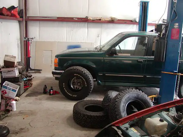

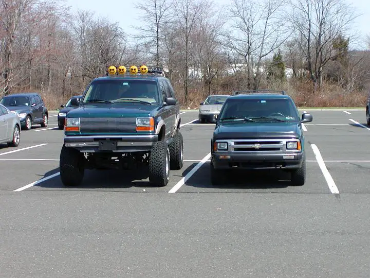

Lifted Higher now!
First pic, parked next to a 4wd blazer.... more to come!
added another 4 in front with Tuff country setup (EZ Ride, which does ride great!)
and SOA in back, for a total of over 9 and 11 front and rear...
not sure on tires yet. I'll probably run the 33's until dead then swap rims and tires at that point by going bigger on both.
paint job should be done by then, which will kind of dictate wheel / tire combo....
It looks like it's just SLIGHTLY taller than the Blazer. :D Lookin good. :thumbsup:

looks good me likes :D one question... could you snap me some pics of how the flares mount to the doors? I have a used set and have yet to figure it out. Thanks for any help.
:chug: :chug:
:chug: :chug:
the door flares are just held on with double sided foam tape, about 3/8" of an inch wide. its the same stuff that goes all the way around the top of the front / rear main flares....
(i wasnt real impressed, but they are staying put.)
they are deflecta shield flares from a 97 i got off of ebay.....

time for a front soa.... 11 inches of lift is a lot for only 33s..... fenderguy had 4" of lift and 35s with trimming
Front is 9 with 4 inch springs, and could still go higher with 6's.
everything aligns right, and the truck isnt used for climbing, so for street use, TTB is still OK with me. (until it breaks, of course.)
tires and wheels will get bigger !!!! :D :D :D
