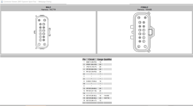

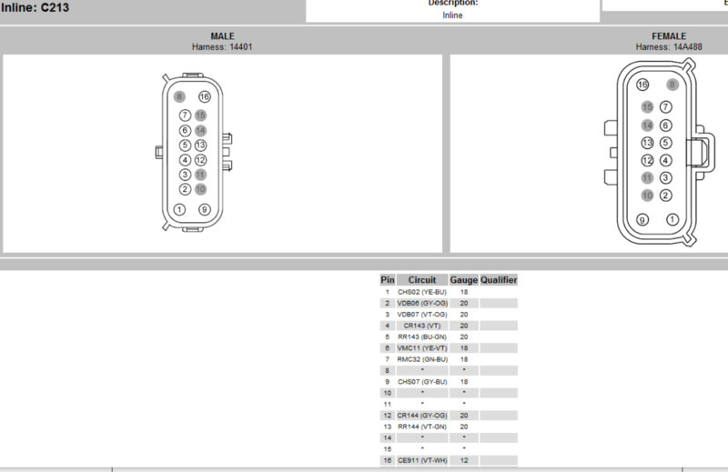

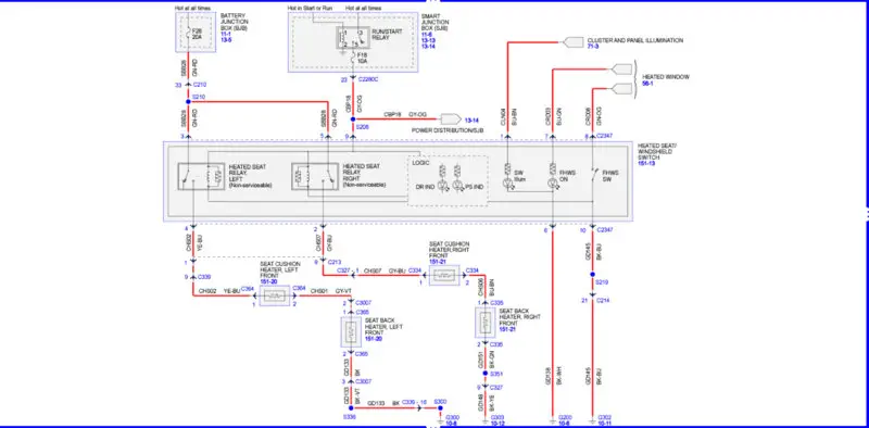

These may help in figuring out the wiring. For the passenger seat, both heated seat element connectors are under the seat, one gray, one green. Both are 2 wire connectors. The seat heaters are wired in series, so any break in the circuit means both seat bottom and seat back will not work.

Paul,
Donyou have this diagram for the driver seat and possibly for a 2008 explorer with 10 way power seat? Went to dealer and they couldn't even get close to what you have. T/u
Paul Fithian
October 12, 2016
279
65
Long Beach, IN
2007 Job 1 RWD V8 Limited
No
kaw900r
April 9, 2019
21
Ohio on top of the mountain
07 xlt v8
Working off of these trying to see what to match up with new wires. Tried putting power to seats power and ground but nothing. Wondering if needs to be connected to door module?

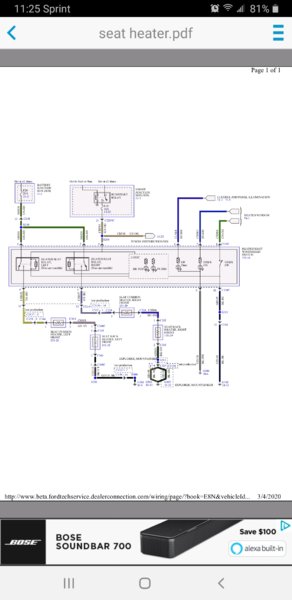

Pulled center console and face plate yesterday to find no wires or plug to go to heated seat button. Going to do the splicing today and see if I can get the passenger seat to now that I know what is the power and ground wires...
kaw900r
April 9, 2019
21
07 xlt v8
Might be the plug for heated seats but it is smaller than the female plug on the heated seat dash button. I will get the plug from junkyard and see if the wires are the same.
kaw900r
April 9, 2019
21
07 xlt v8
Seats are in and working. Now to get heated seats working, have hot wire to switch when car is running and wire to seat wire yl/bu & gr/bu but switch never lights up.
