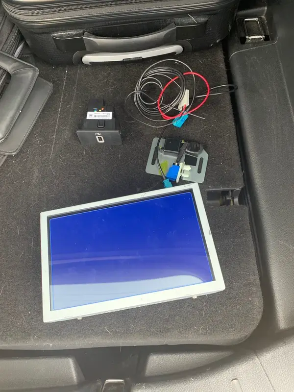

So I've installed the radio and...SUCCESS!!! Partially, but still success
Here's some pictures
The install was very easy, and since the unit came pre-programmed with my VIN, I didn't have to worry about it.
Now, one question I do have. To be able to use the Apple CarPlay, I upgraded the USB plug, which eliminated my SD Card reader for the NAV, giving me a NAV fault error. How do I give the Sync 3 maps if there is no SD reader?

Congratulations!! Sync 3 maps are loaded in the unit's internal hard drive, SD card is not required for Sync 3 maps. What is the error you are getting? probably it is not related to SD card

As mentioned Sync 3 does not use the S/D card for updates. I believe the only way to update the navigation currently is with a USB drive that is linked to your VIN and is dealer installed at a price. I'm not sure if it will eventually be available using WiFi and again I'd think that it would be VIN specific with a fee.

It only says:
“Navigation Fault
Navigation is not functioning properly”
I’ve contacted the seller and he’ll be sending some “tools” my way. Whatever that means. Lol
Gps antenna works fine as compass was wacky at first and now its working normal.
Honestly I use the Apple CarPlay and google maps much more than what I use the OEM navi, but having that little exclamation mark pisses off my ADD lol

Gotcha, unit came with 3.2 software so I know it’s got one of the latest, i think.

the seller sent me an apim tool, which once connected by USB on the laptop he was able to reset the module. All is working fine now!
