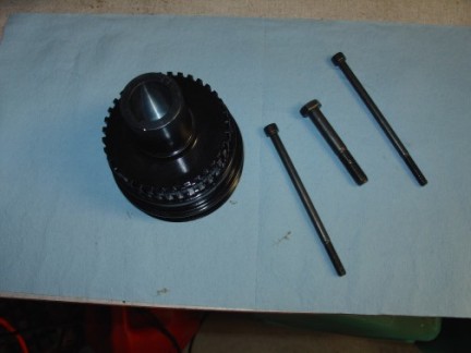

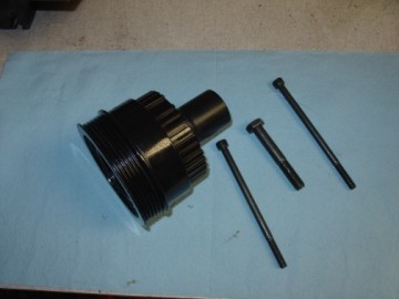

The ASP UD and harmonic balancer is actually 1 lbe heavier than OEM.
Is a very highend product with 0 problems reported so far on the OHV and SOHC engines

I have had an ASP underdrive pulley with dampner on my 4.7l dodge for about a year now with zero problems except a painful install.
I was thinking about this last week knowing ASP made ones with dampners. post results, maybe we can get a petition together to get one made for the 5.0.

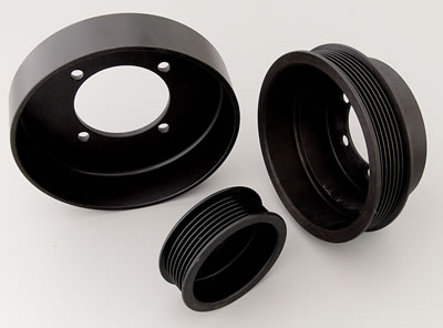

my dad was looking at pullies off summit racing for this 98 5.2 durango and the forum he is on is run buy a master mechanic for dodge and he told him not to get them becuz they will screw up the engine. http://store.summitracing.com/default.asp?target=egnsearch.asp&N=115+-59186+-59491+-42619 i forget exactly what it was that got messed up but he didnt get the pullies... is there a way that this new pullie would mess up the engine?
If, and thats a big IF, the pulley reduces the water pump to a point that the engine can overheat at idle speed, the overheating could harm the motor, This would also be very easy to prevent; simply rev up the motor if the temp increases.
