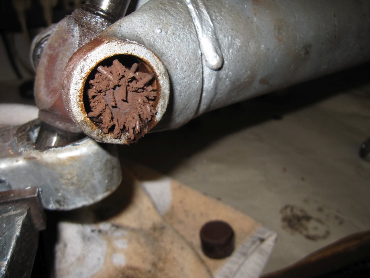

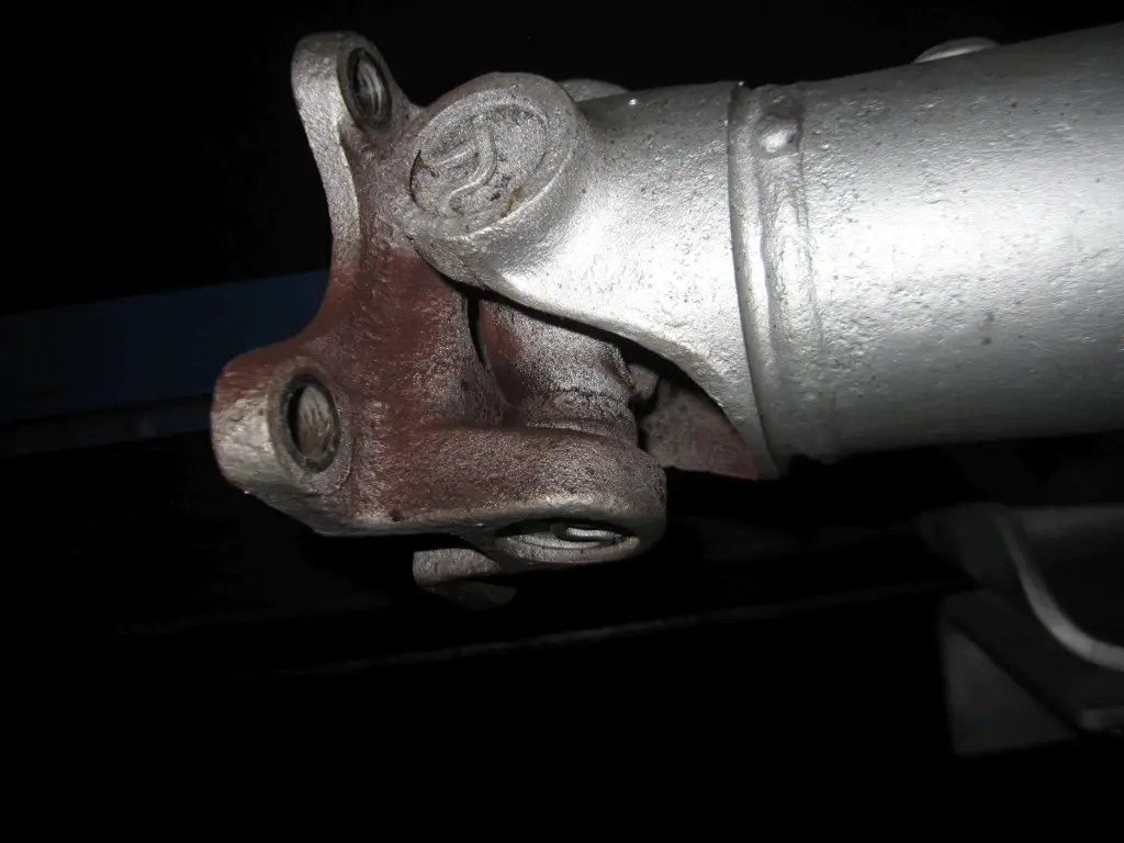

Hi,
if you hadn't mentioned that the vibrations occurred after replacing the joints,
my first thought was it could be a bad shaft U-joint.
Same behavior
- first slight vibration, not to feel in steering wheel
- vibration getting worse over the time, feeling in your seat, location diagnose from the rear
- bad vibration starting from a stop, at the end stage with squeaking
If there are any signs of rust the u-joint is dry and worn.
Any vibration comes from rotation, every worn bearing/u-joint can cause this.
