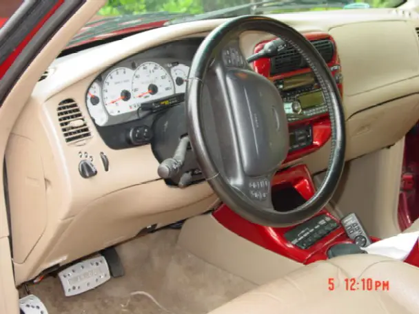

In case anyone wants to know, Ford does carry those shift indicators for these guages. I bought mine for about 20 bucks. That is the part that says " PRND21 " in case someone didn't know what we are talking about. They also have the red indicator needles. Here was mine.

Here's mine:
Dead Link Removed
